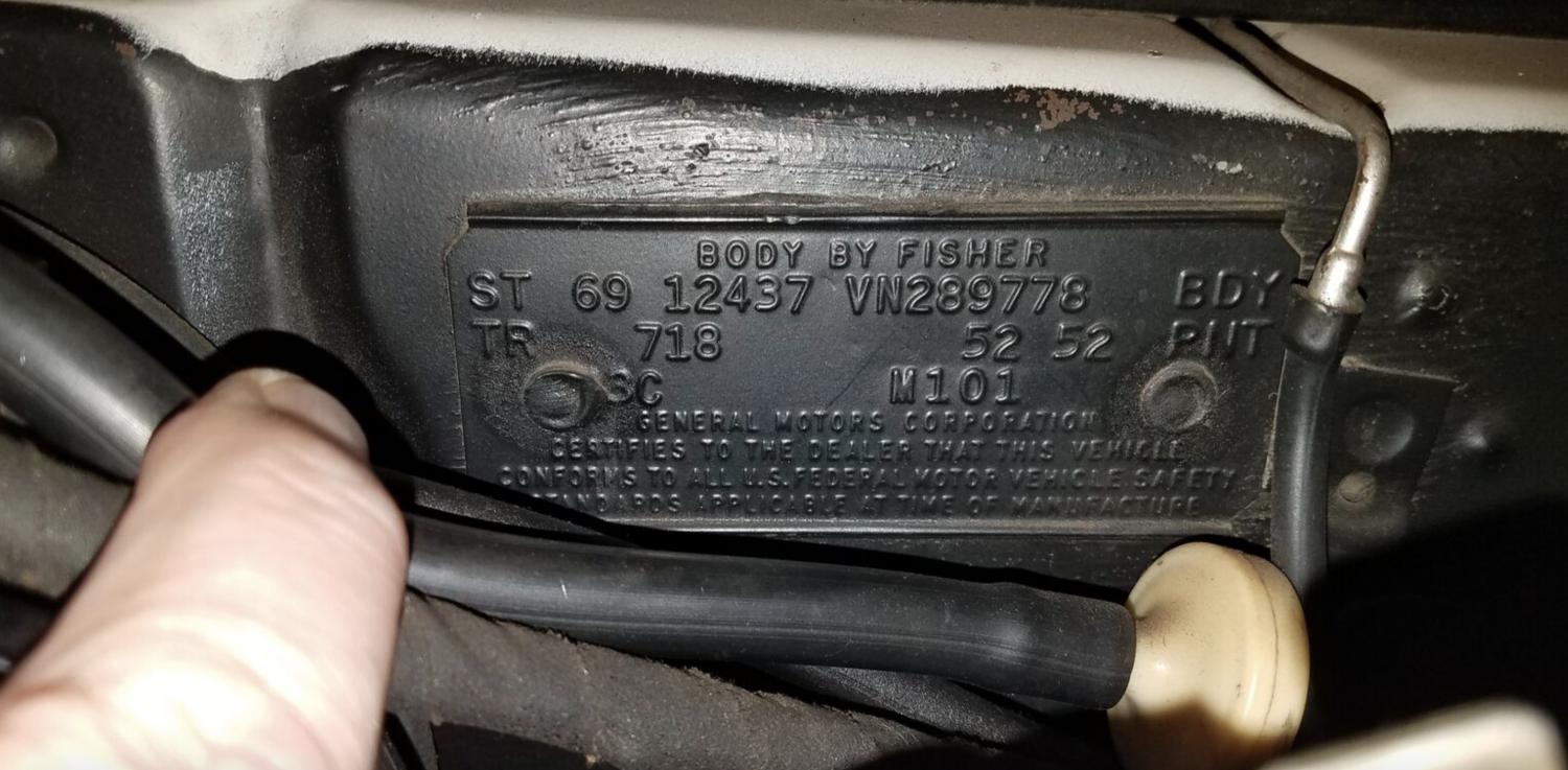

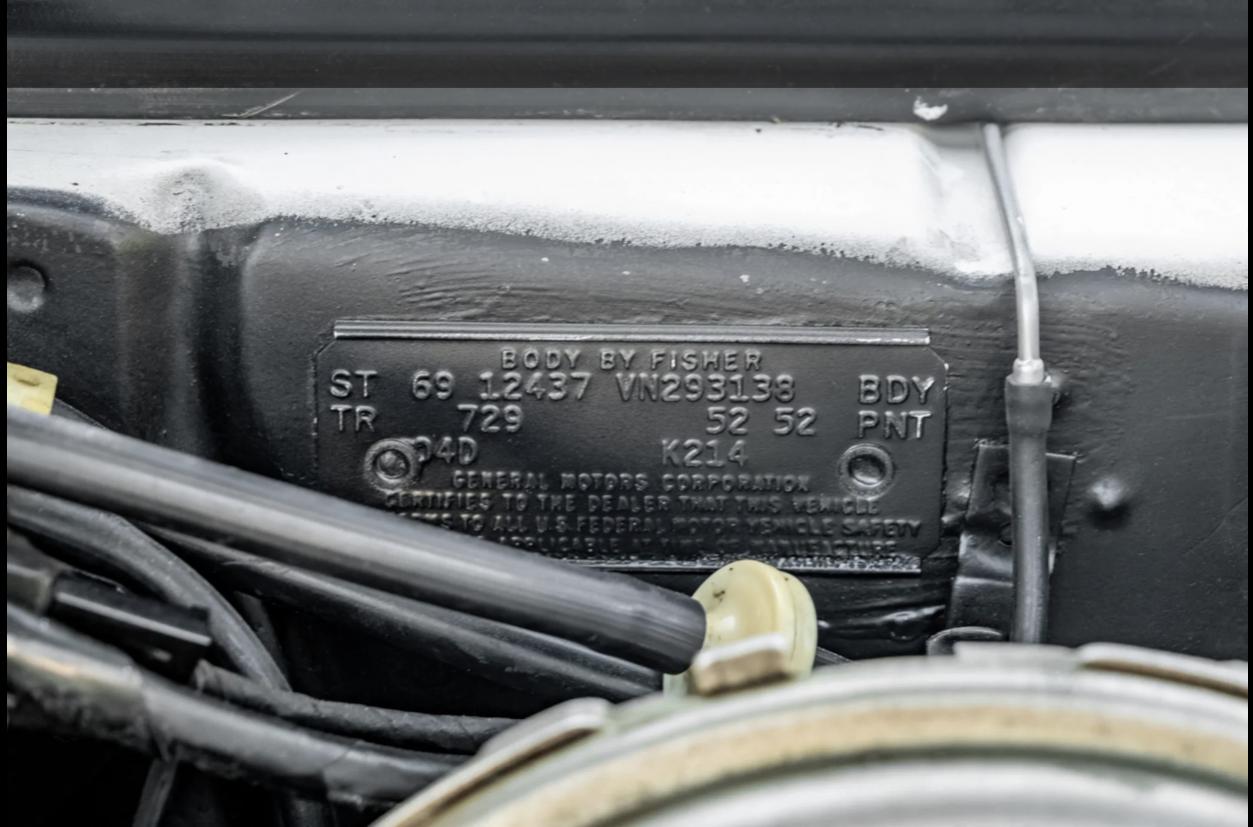

Interesting.... Looks like the original cowl tag was changed out since I last saw this car.
Old Tag, which Im sure was original, had different Interior code (718) Standard Red, Body number, week of production and LA Scheduling code.
At that time it had non matching drivetrain. (engine, trans, rear)

Heres all you need to know
Original Tag:
The Following User Says Thank You to Jonesy For This Useful Post:
mhm1966 (09-19-2022)

Replacement/Reproduction Cowl Tag now on car
Old 09-18-2022, 05:08 PM
Jonesy's Avatar
Jonesy Jonesy is offline
Location: Duluth, Minnesota
Posts: 3,134
Thanks: 335
Thanked 795 Times in 496 Posts
So when it was listed on ebay it had the original tag, but had the houndstooth interior and someone who bought it must have changed out the tag to match the interior
