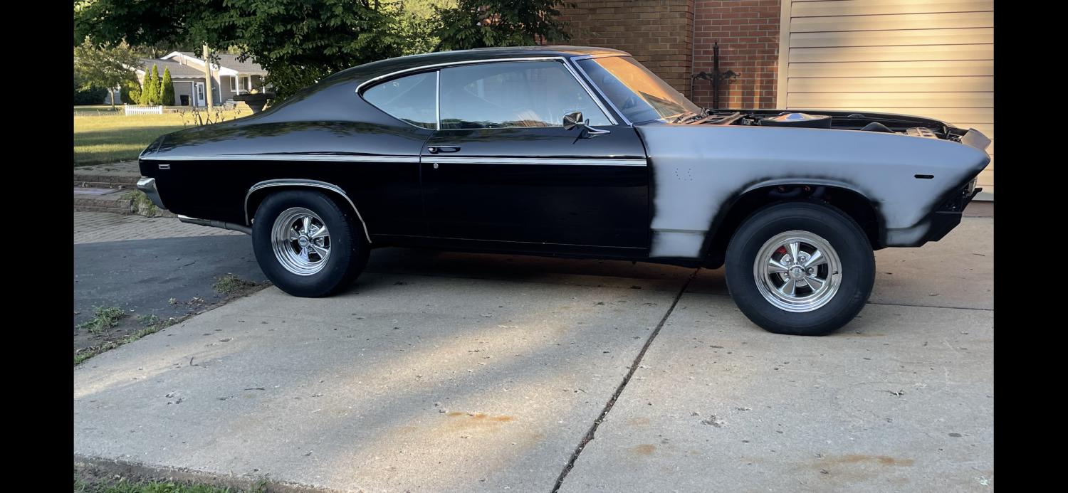

I have a set of 15x5 Cragars round spokes I want run on my 70 Chevelle. I know the majority are running the 6.70x15 or 7.10x15 on the 15x4’s. On the back I am going with the 275/60/15 Pro tracs. I am curious if anyone here is running the 215/75/15 pro trac front runners on their 15x5 wheels? I am trying to see the differences between the 7.10x15 verses the 215/75/15.
Thanks,
Ray

I tried a set of the Pro Trac front runners and they were not my thing at all. Very small, and the worst part is that they are formed with a high-cut rubber block or a stepped ridge that's formed on one side so letters can be cut. It really looks weird without the one side cut for lettering and forces you to mount that to the inside so people can't see it. Looks like the tire was never finished and that's how Coker ships those. (Ugggh)
I have since gone to the Champion 500 Firestones which I much prefer with the 6.40.15 size. Great looking tire, fits the wheel well nicely and looks good with Pro Tracs on the rear.

Here are the Pro Trac 5.60-15's (too small height wise) on my old 69 and a set of Firestones on TT which are a better-looking tire IMO. I think the 700 tires look too tall for street use and overfill the wheel wells. (just my opinion)
Pro Trac 5.60.15 on 4" Cragar Front
Firstone 6.40.15 on TT 5" Front
