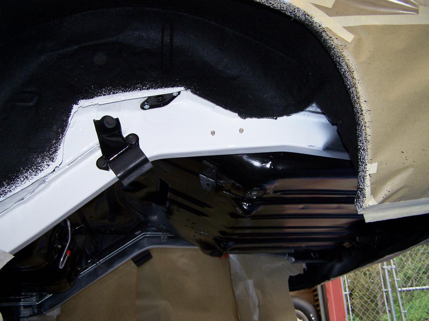

Default 3M product and applicator gun RESULTS
This was my amateur attempt on my Driver Z11 (LOS)
Using the above 3M product and "gun"
Frame on underbody Fluff.
