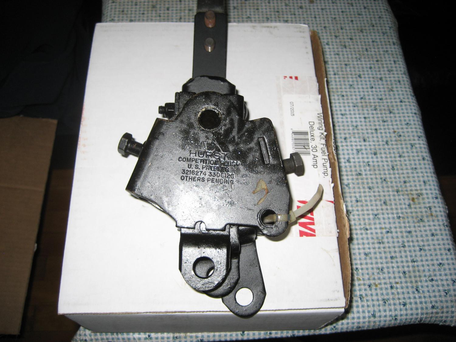

-Muncie trans. with Hurst CP shifter...shouldn't there be bushings on the shift levers?

Yes the shifter rods should, have bushings. Plastic is standard for "normal" use, but steel are available if he is going to stir vigorously.

That is a Camaro shifter not the correct one for a Chevelle.

Correct Chevelle shifter.

I kind of figured that when I looked at it...he says it has worked fine, so we will leave it alone. The vin stamp on the tranny is from a Camaro and the tag #3946797 denoted L34/L78.
He is cleaning the tranny and detailing the components...sent him info for bushing kit.

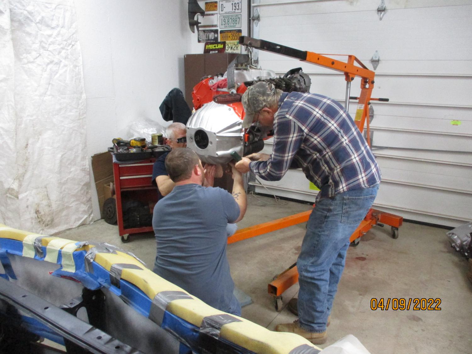

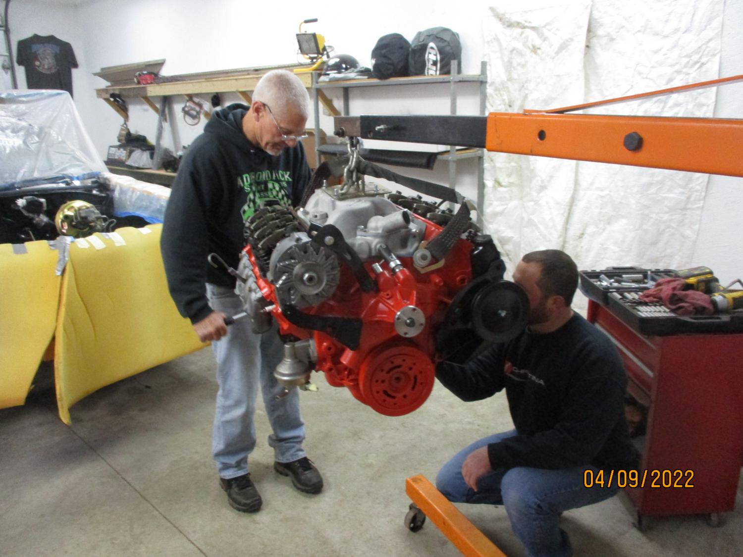

Engine and tranny went in today...we had the usual issues with bolts and odds and ends...some swearing...but it all happened. Still lots of detail work to do, install radiator, new inner fenders, trim out the engine bay, etc.
The boys did a good job.
