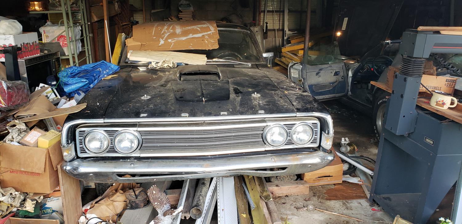

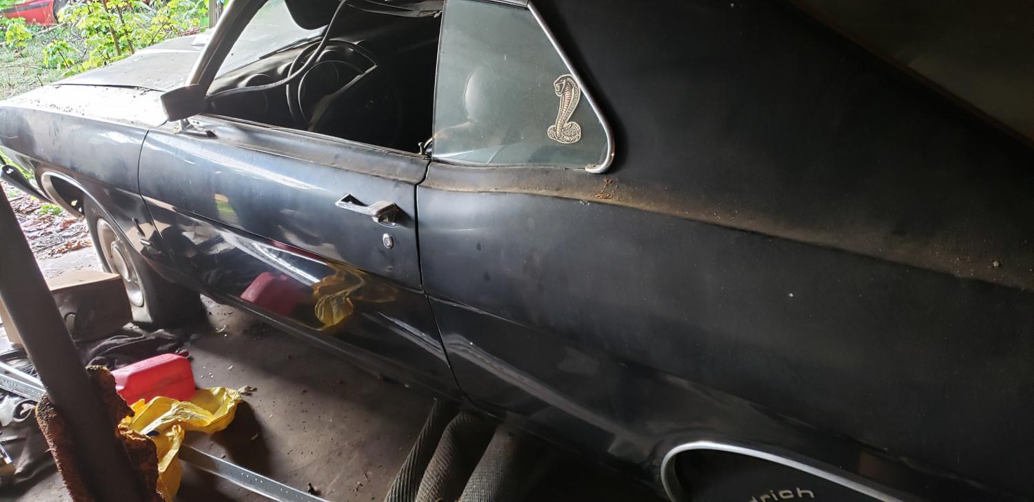

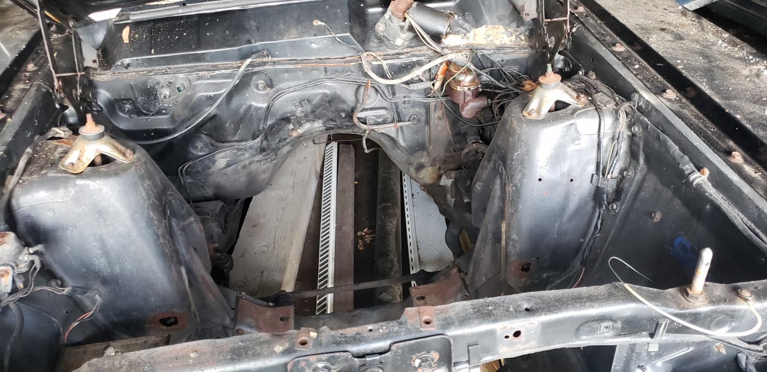

Guys, got offered a car that is totally outside of my world. No motor or trans it would seem, still need to look through the garage - looks to be nearly rust free, trunk floor is solid.
VIN is 9A45R172XXX
Body 65E
Color W
Trim CA
Date 26M
DSO 25
Axle W
Trans 6
Any idea of value that wouldn't hurt me or the seller? Ball park is fine.

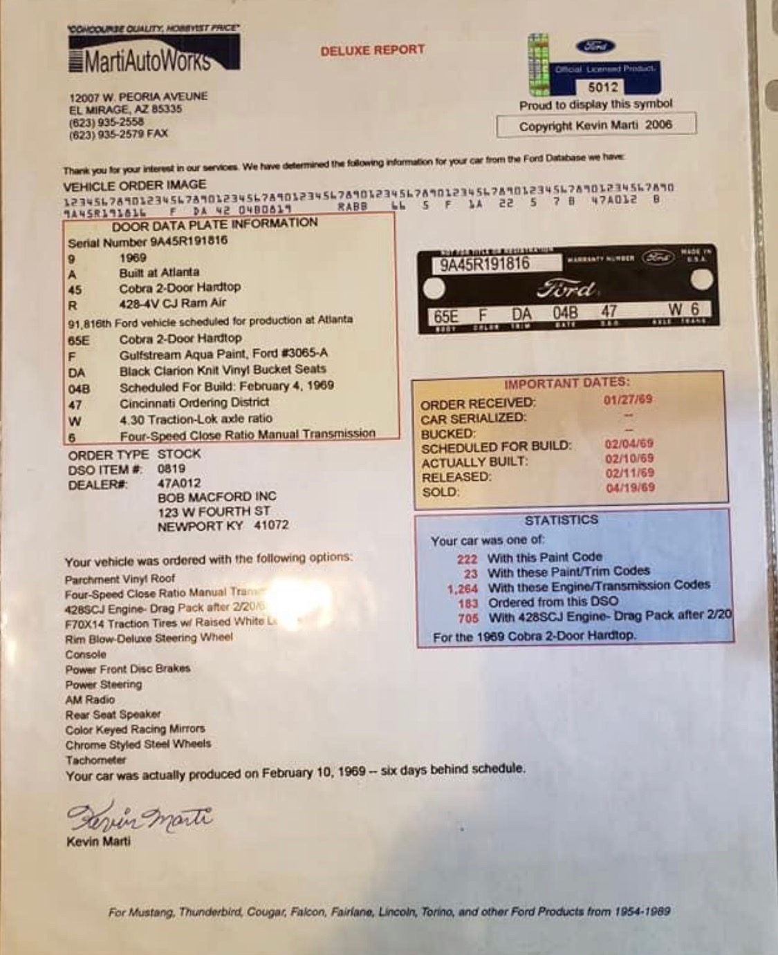

That's a (Fairlane) Cobra with a 428 Cobra Jet with ram air.
W axle is 4.30 gears, which means it has the Drag Pack, making the CJ a Super Cobra Jet.
Trans is a 4-speed.
Attached is a Marti Report for a similar car. They can be confusing to read for some so just ask questions for clarification.
Go to this site's forum to ask value questions: torinocobra.com

Good advice from 442w30...if it has an oil cooler it's a 428 SCJ and they came with either 3.91's or 4.30's. It looks like it might be a 4 speed and if so, would have had a top loader (big input/output shafts).
The formal roof Cobra's are cool cars and for some, much more desirable than the fastbacks. The factory HP was underrated @335, torque @ 440 lb. ft.
Back to your question about value as is...without engine or transmission and depending if it's solid...I'm guessing 8-10 K.
