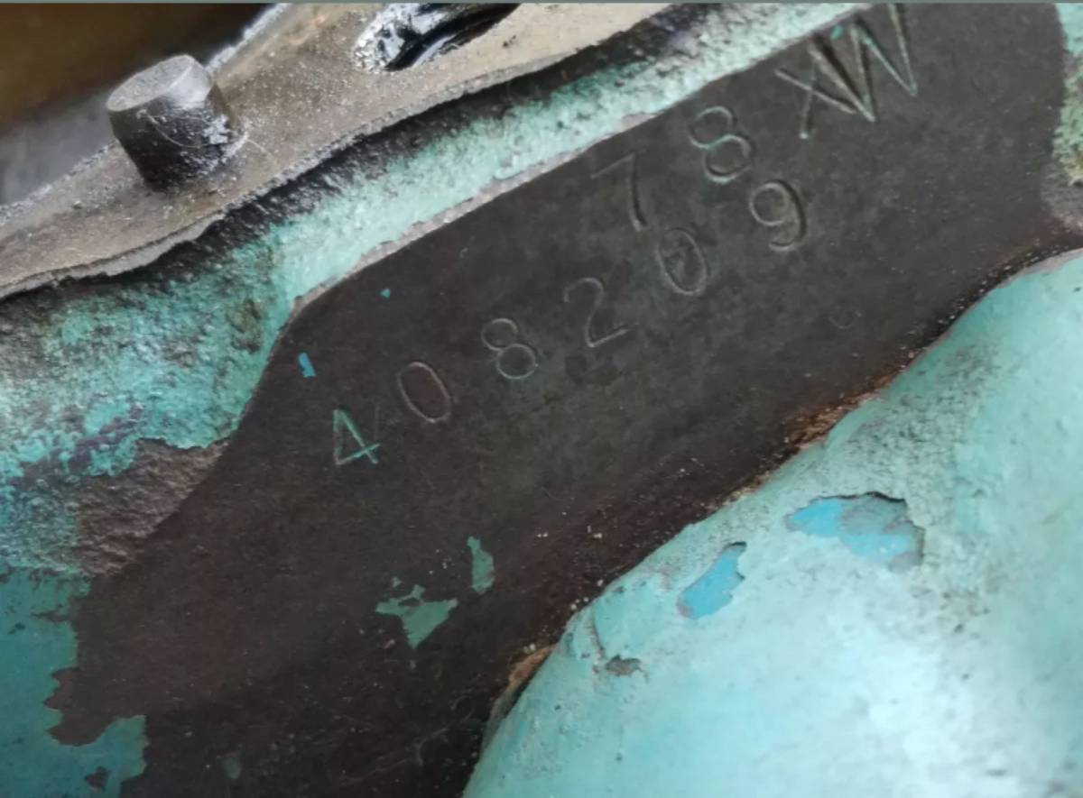

1964 GTO with a claimed 1321 miles. Move to for sale section if necessary ( I don't have clearance to do so.)

Huh, really.
I see a ‘64 with 101,321 genuine miles on it.
Many issues with this car.

Looks like nice fresh engine paint. Pontiacs don't keep paint on the cylinder head exhaust port and intake heat riser areas for more than five minutes after first start.
Look at the different color under the chipped area.
...oh and by the way in this photo the cylinder head is missing. You're looking at a short block with the locating dowel visible.

This block stamp 78XW = 389 / 325 HP / 4BBL. / 4 Speed.
Looking at both links offered on this ‘64, one shows Power Steering and the other does not.
One has no console and the other has a 67 console front missing the wood grain, with a 65-66 console box lid.
Plus a 65 horn bar and center cap.
That’s ^^^^^ just to name a few.
I certainly hope no one falls for this mileage and price.
Shame Shame!

Fan Shroud on a 64 TRipower? 64 original TriPower should have a vacuum linkage setup, Run from that one!

I only glanced at the CL ad - this car has more issues than Time magazine.
I think that shroud is correct for an AC car.
