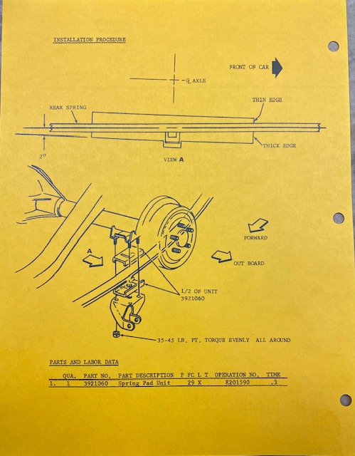

I was looking through service bulletins for something else when I came across this one. Good explanation of the usage of p/n 3921060 G.R. 7.545 Cushion Unit.

Well, that's interesting . Those replacement pads must be super rare, if they were only made for correcting the "shudder".
I don't know if you should use those on a car built after Feb, 1967, as it may change the pinion angle too much.
