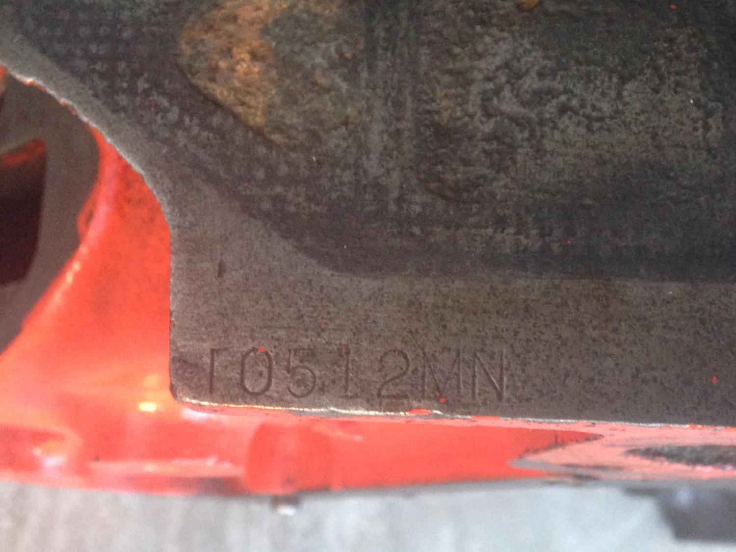

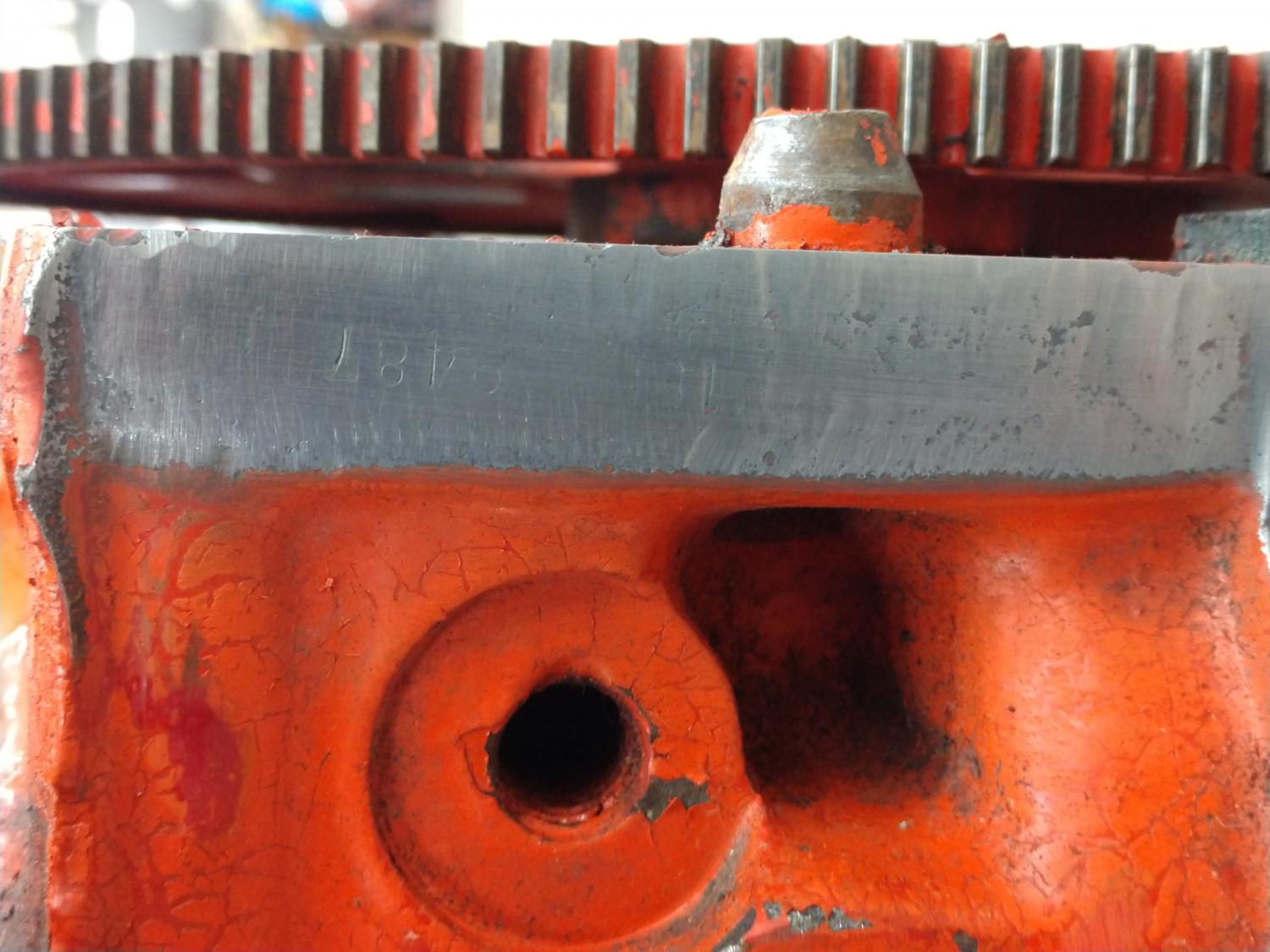

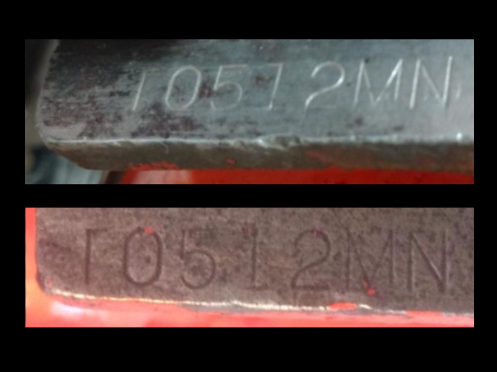

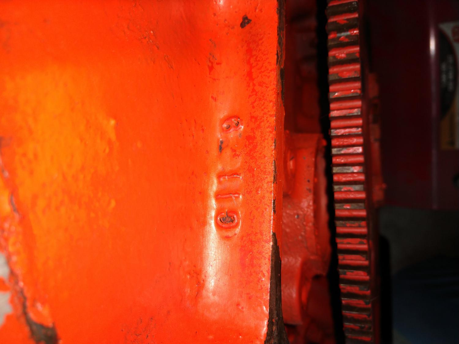

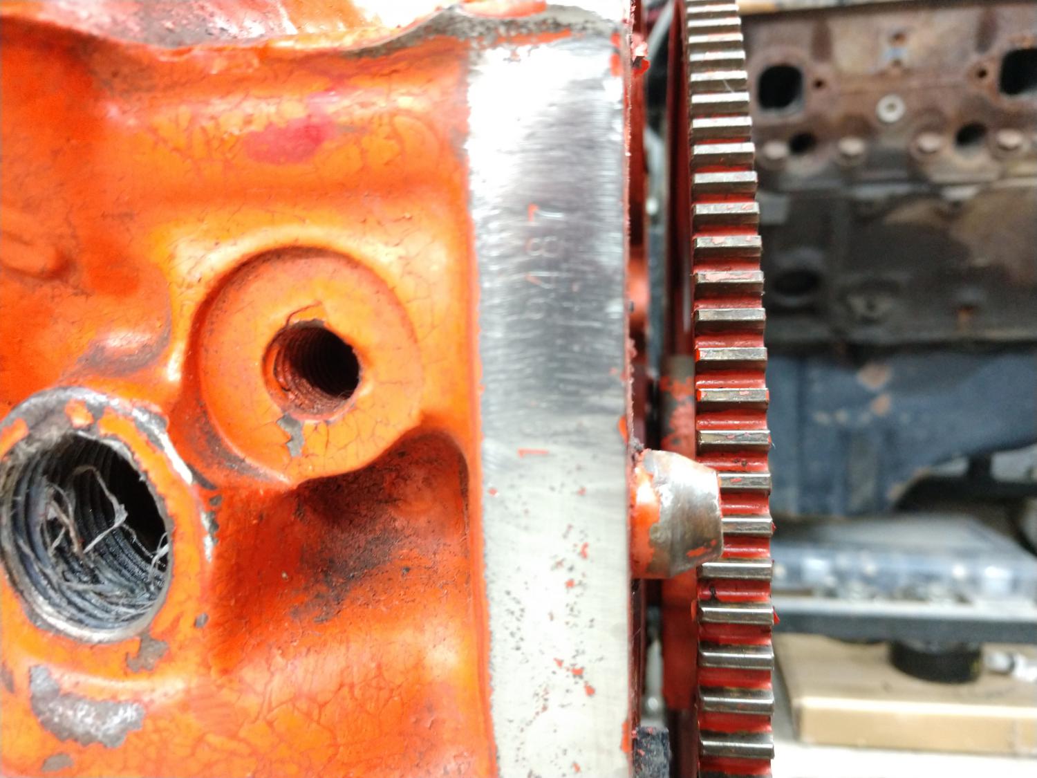

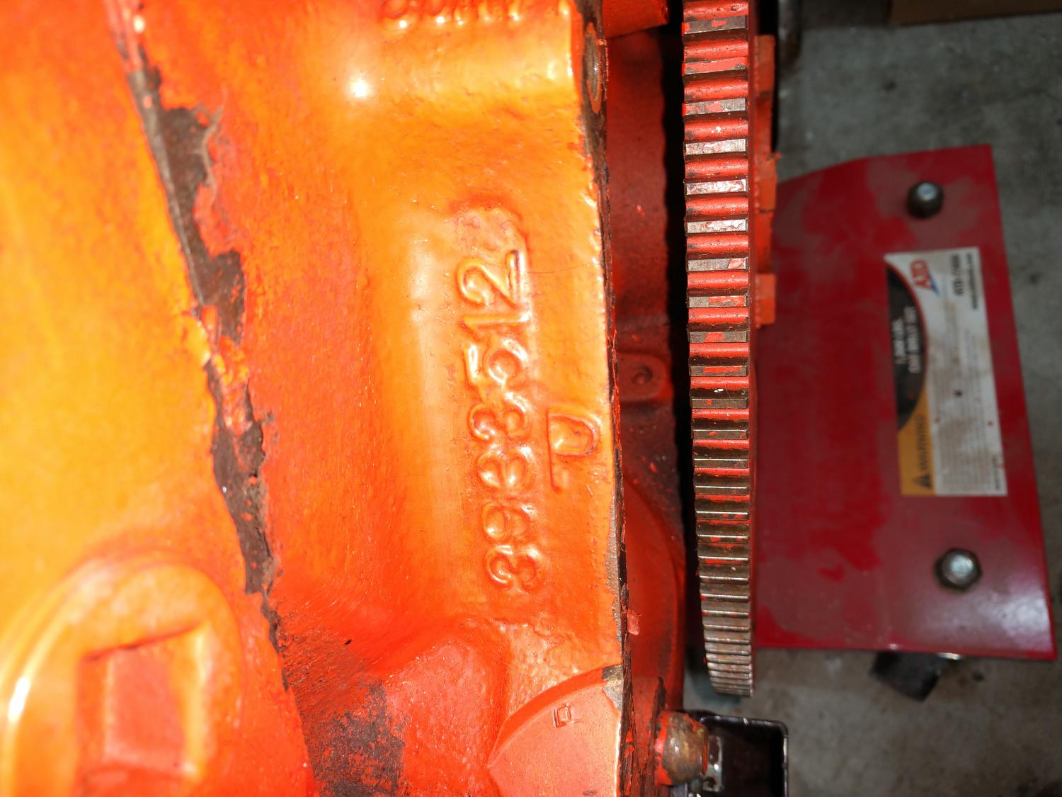

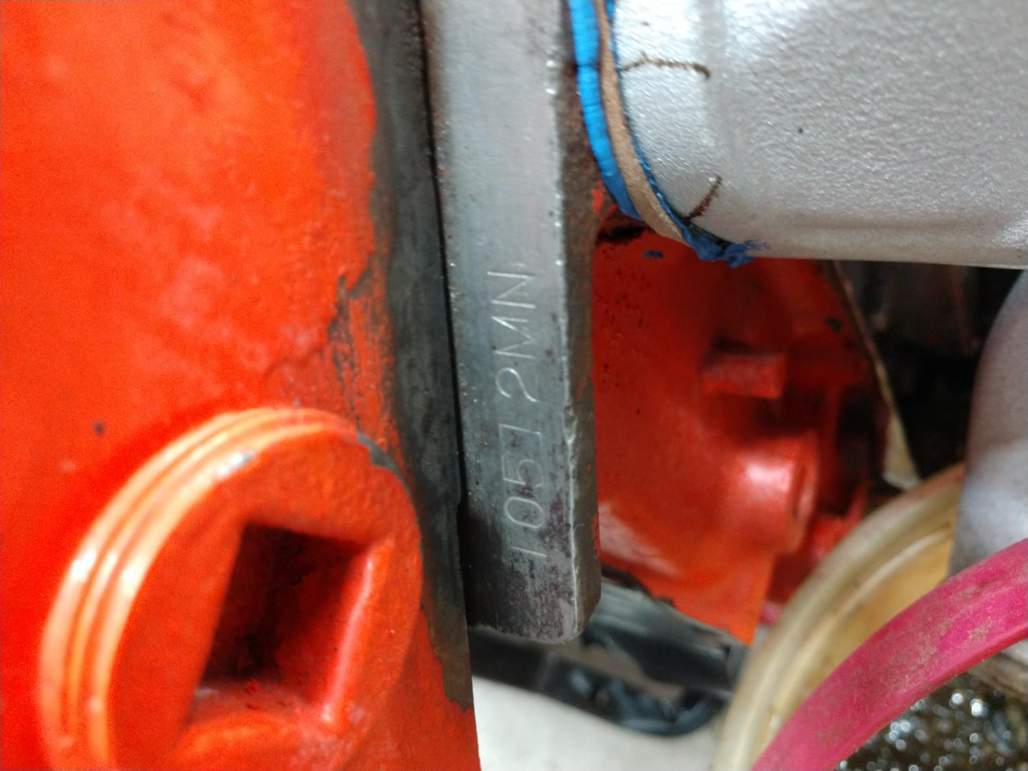

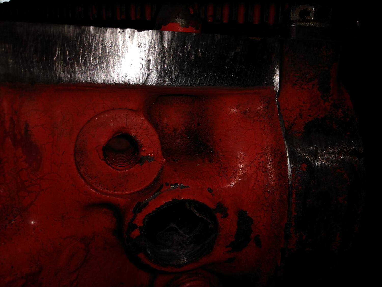

Hello guys, I'm new here and thought I'd throw this out there and hopefully, find the car this engine belongs in.. Pretty sure it's a '69 COPO L72 427/425?? It runs, big, solid flat tappet cam. Heads are the CORRECT "291" Square castings but the date is too late (J-30-9) I haven't disassembled yet.. Came out of a '67 Caprice I recently purchased. Pulled it to put a tamer 454 in and checked numbers and researched how rare this engine(Or at least the block) is... Hoping the car is still around?? Trying for some good photos tomorrow.. NUMBERS BELOW��
*Block #3963512
*Block casting date is C-11-9
*Right Front deck stamping is TO512MN. Correct to a (4SPD.) COPO
*VIN#19N 9487(Above oil filter, vertically on block bell flange) 19N I'm pretty sure is a Camaro installation?..Only the last 4 of VIN (not 6)are stamped here. I've read that Norwood got sloppy on protocol sometimes?
Thanks very much!

Well, whoever took the grinder to the VIN number all but ruined it for the whoever may own the car.... since the surface has been ground on, the VIN stamping will always be suspect. Not cool.

Let this be a lesson...do not ever, EVER, EEEEEEVVVER under ANY CIRCUMSTANCES use a grinder or even sandpaper to clean a numbered surface on a potentially valuable engine or any other vintage car part for that matter. You have SERIOUSLY devalued that block.

The first numbers should start with 65?

Am i missing something? Isn't a restamp anyway?

Assembly stamp looks awful "new", but characters look correct and a good date. I believe that this is a good stamp from that assembly date.

Doesn't look bad compared to that stamp.
