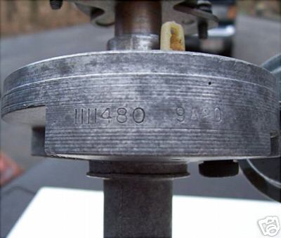

i have an early dated 1111480 distributor, looking to see if anyone else has seen this date.
I am looking to sell it but not sure what it is worth

i got this distributor with a car and it is suppose to be an original but would like your input

Need a clearer pic to be certain.
111148 all look good.
The zero is suspect. Is it just damaged or are there remnants of a previous digit?
Lots of other get "converted" to 480s. 483, 488, and 489 are more common.

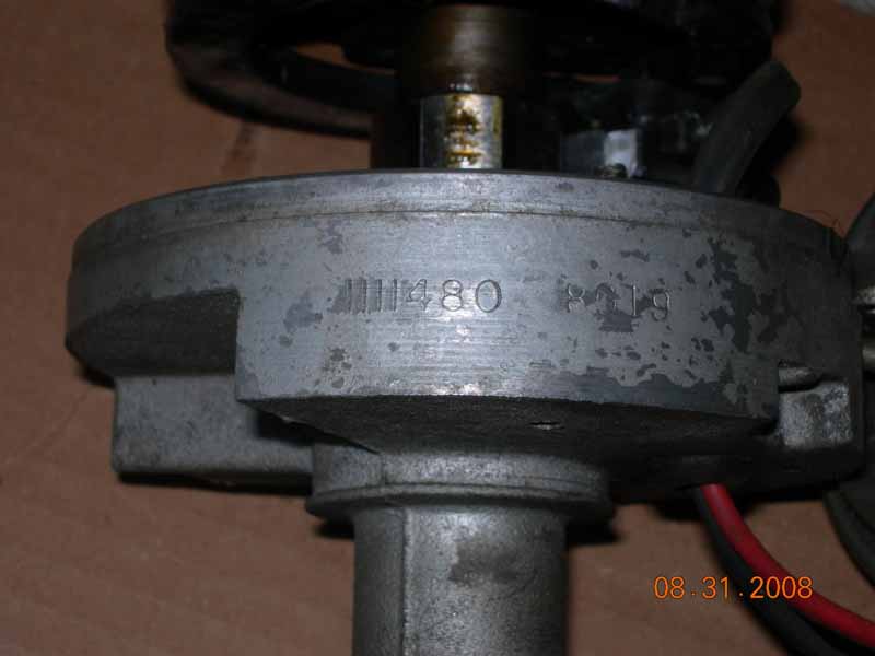

Also, these were normally run I batches, I believe. May see if you can find a legit with the same date.
Pic of a legit one from Jan, 69.

might be the pic but the o is not right,too oval.

Agree - 0 does not look right. Looks like another number was underneath and redone

My 1111480 dated 8 G 19 for a 10B Oct 68 Z.

8g8 is not a good date.
