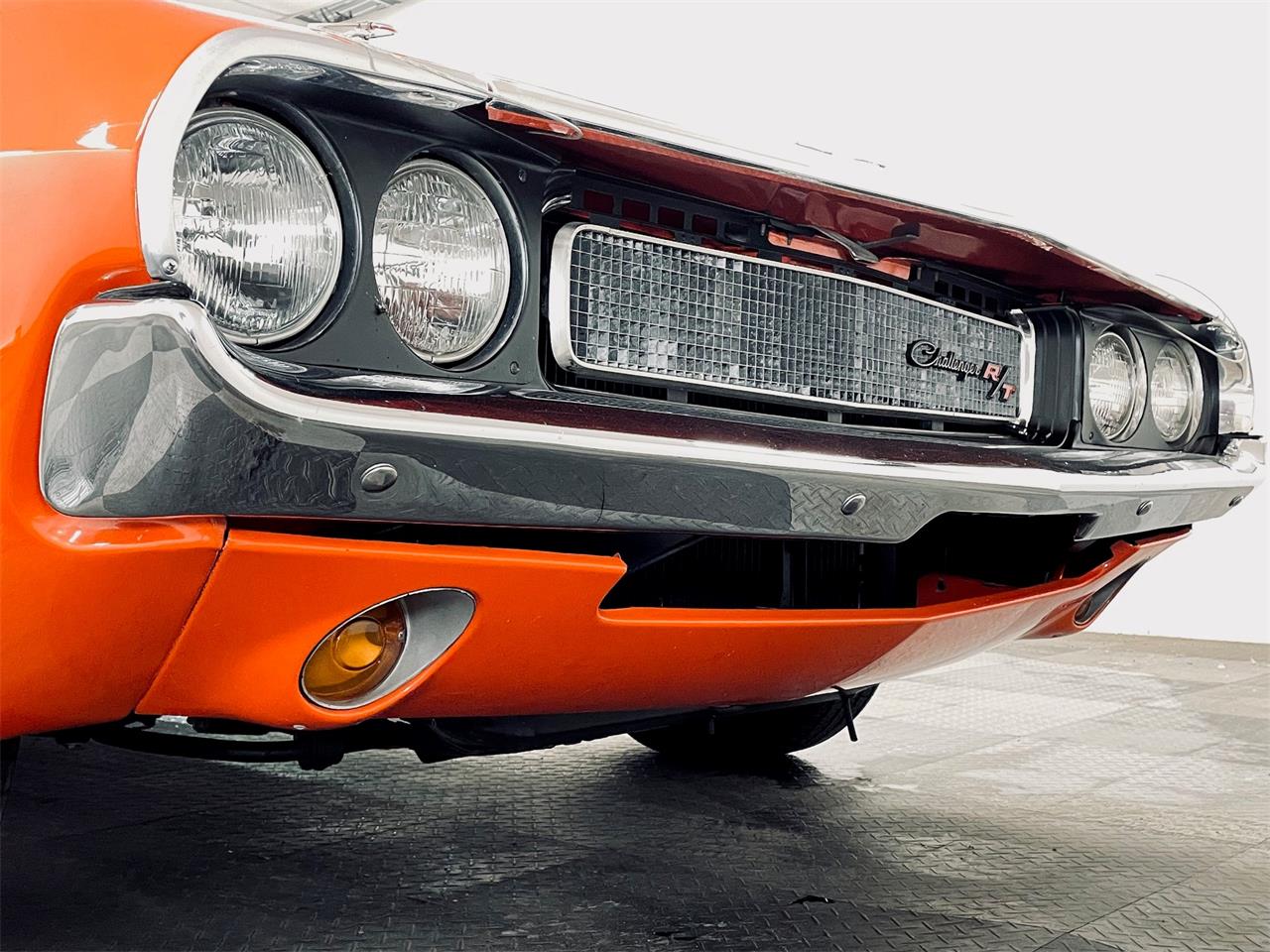

Honest opioions on this car please??

Looks like a nice driver quality car. Front valance to lower fender mounting is a little wonky on the passenger side.
