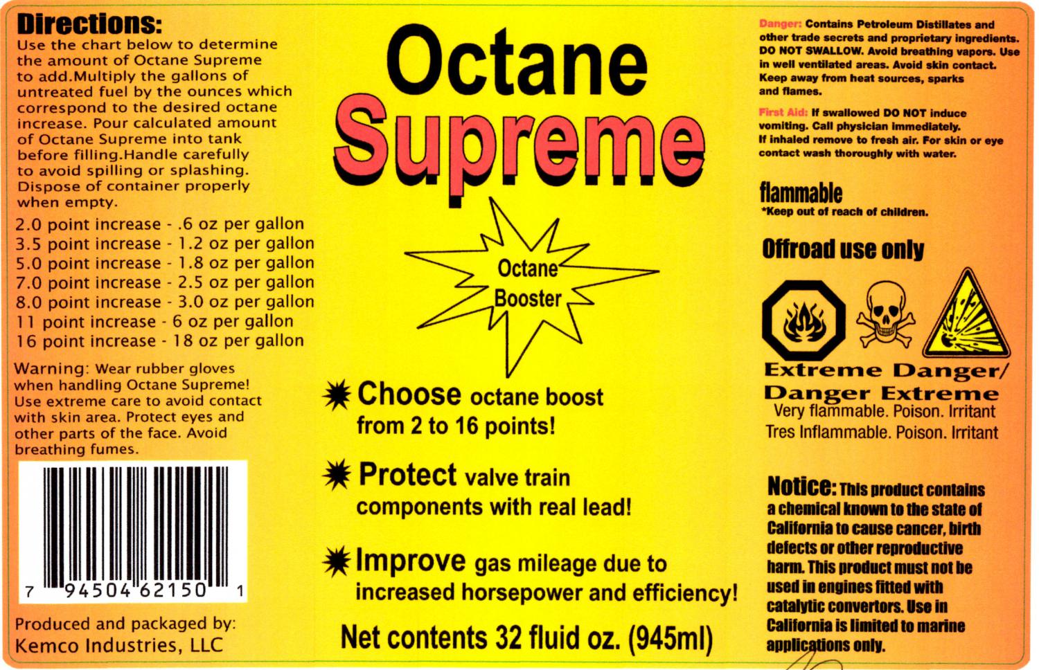

Default Octane Boost
Available from Wild Bill's Corvette. Don't get it on your hands. I find it works as good as the avgas and much more convenient.
