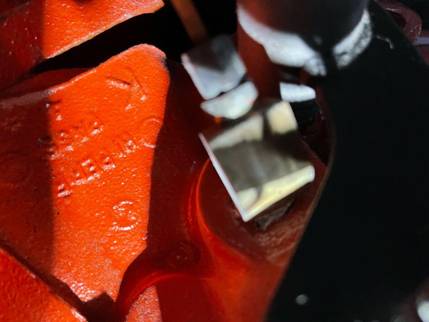

What do you guys think about the pad? I kinda dig the original red interior...which looks to be all GM.

We had a 67 SS396 and the pad stamp didn't look like that...the '7' was offset, kind of askew from the other numbers. Ours was a Fremont built vehicle, maybe each plant was different ?? It doesn't look right to me based on others I have seen...but I know we have experts here who can sort it out....like Mike Crown.

----No broach marks,,,no good! Add to that the cast iron intake,,,really!.....Bill S

Restamp

I agree with Wilma. I've never seen a '67 VIN stamp on a deck that was lined up properly like that. Coincidence that they got this one straight? I doubt it.
Strange lines on the deck surface... almost looks like it was painted with a brush. I'd want to see it with the paint carefully removed, but I suspect there are no broach marks.

The specific to L35 only (396/325) radiator gives hint to the car's origins, but credit Jeff Helms usual logic as to why an oval port, 2 bolt engine would be re-stamped "EG".
Al Colvin's CHEVROLET BY THE NUMBERS incorrectly lists The L34 (396/350 EF engine code) as "EG", which in reality is the code for L78 (396/375). Meaning that whom ever was attempting to upgrade this car to L34 status (appears to have an Edelbrock carb with square bore intake as opposed to Q-Jet) relied on incorrect info, and now it is being passed off as the Holy Grail L78.

The block pad stood out immediately, but I wanted to see what others said. The deck appears to be at, or lower, than the water pump gasket, which would indicate it having been machined, "to remove rust and defects".. right ???

For searches -- 138177A166602
I asked the seller for pics of the oil line holes to verify what I already knew (I saw pics of this car several years ago, unless there is another white one with an L34 stamped EG). See below. 2 bolt main. So definitely not an L78 block.
Gang stamped VIN would be OK for this Atlanta car built in that late production time frame. But the Tonawanda stamp is bogus for several reasons (in addition to this being a 2-bolt block).
67's were in a transitional period on the engine VIN stamps. One Chevelle plant used a gang holder the entire model year. Every other Chevelle plant individually stamped each digit at the beginning of the year. By the end of the year every Chevelle plant had switched to gang holders for the entire VIN stamp, except Fremont. I have an extensive library of photos of legit original stamps and can pin down (within a few weeks) the changeover date for each plant (except Framingham which there are so few surviving examples to refer to). Makes it much harder to sneak a fake by me!!
Fremont actually had 4 or 5 different formats during the course of 67 production, and during part of the year they actually gang stamped 7 1234, and then hand stamped the Z in the space and hand stamped the last two digits of the sequence # !! And it is common in that time frame to see the 4th digit of the sequence # overstamped with another number too, when the car got assigned a VIN in the next group of 100 higher than what had been gang stamped on the engine. Lotsa weird stuff happened at Fremont!
