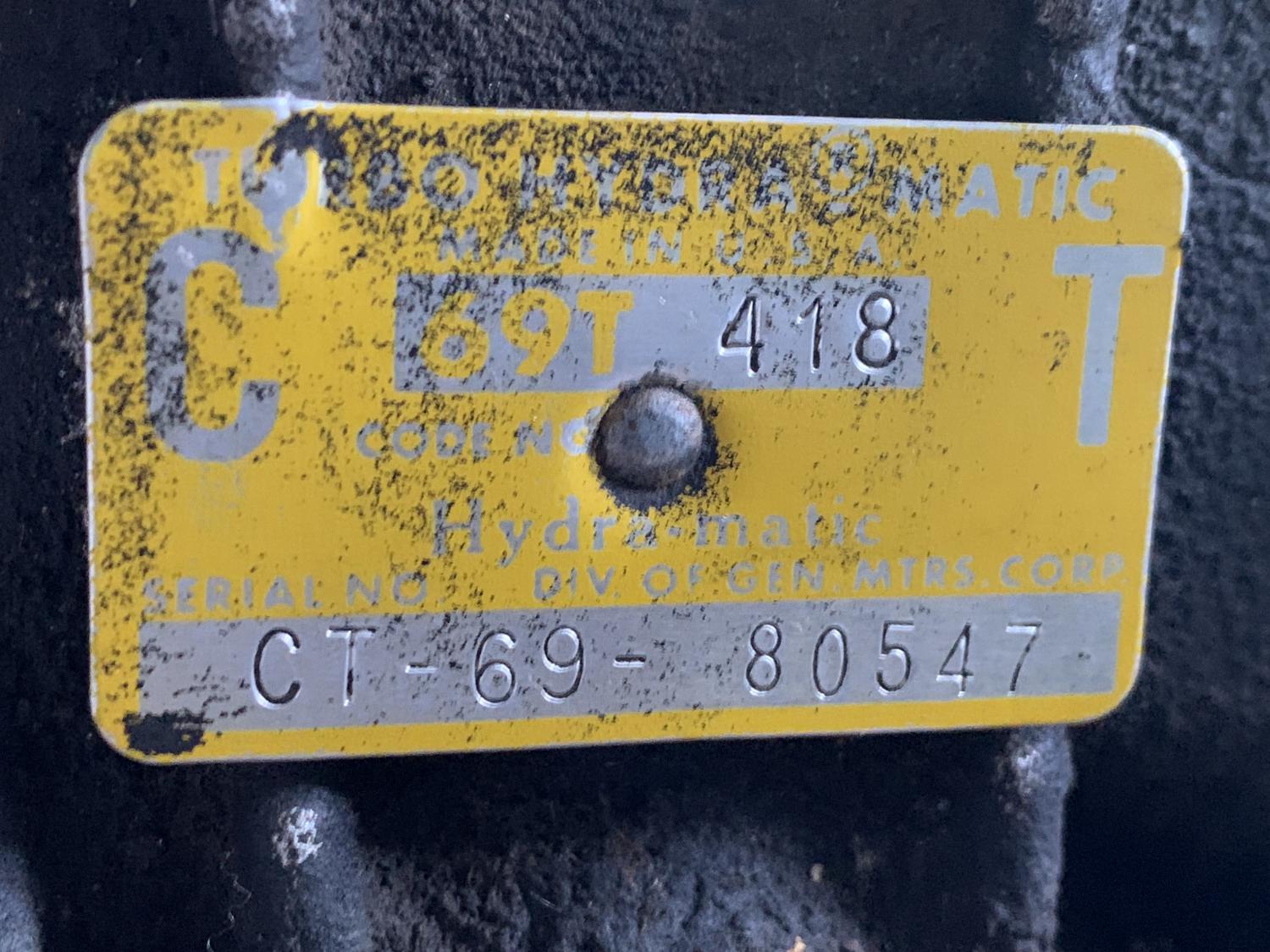

Hello,
Any idea of the application on this Turbo 400 I picked up recently?
It says 69 CT, i remember hearing that the yellow tags were Hi-performance trans applications?
here is a pic, trans supposed to be in working order with TQ Convertor still attached.
Thanks in advance for any help!
Jerry

There should be a partial VIN on it some where. Maybe on the mounting flange or above the pan rail...Joe

I believe that's from a pickup truck.

Post Chevy Pickup Trans Codes..
http://www.teufert.net/trans/t-400.htm
This link should help....

Wilma, do you have any info for Chevrolet prior to 1971. The link shows Buick and Pontiac back to 65 but not the Chevy list. Thanks, Larry

Post Th 400...
https://www.tpocr.com/chevrtc.html
try this....

That is for 69 Chevy truck. Auto trans tags on TH400s (Chevy) were yellow in 1969.

Assembled February 21st 1969.
