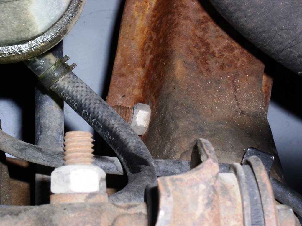

what is the correct style of 3/8 hose used on 69 Camaro tank to line & line to fuel pump

This is what I found on a 69 x66 conv. built 2nd week dec.
3/8 Fuel hose with white re-inforced thread
Coded as follows:
[] GM GAS 10298
With the numbers being a date in the following format
10 = October
29 = 29th
8 = 1968.
After 68 the numbers get more digits 78 88 98 208 218

This is the hose from tank to line on Stefanos 69 Z survivor

I used some of the repop GM gas hose on my Z. It has been on about 4 years and was so hard I threw it away.

This fuel hose is on a 05A Camaro...Joe
