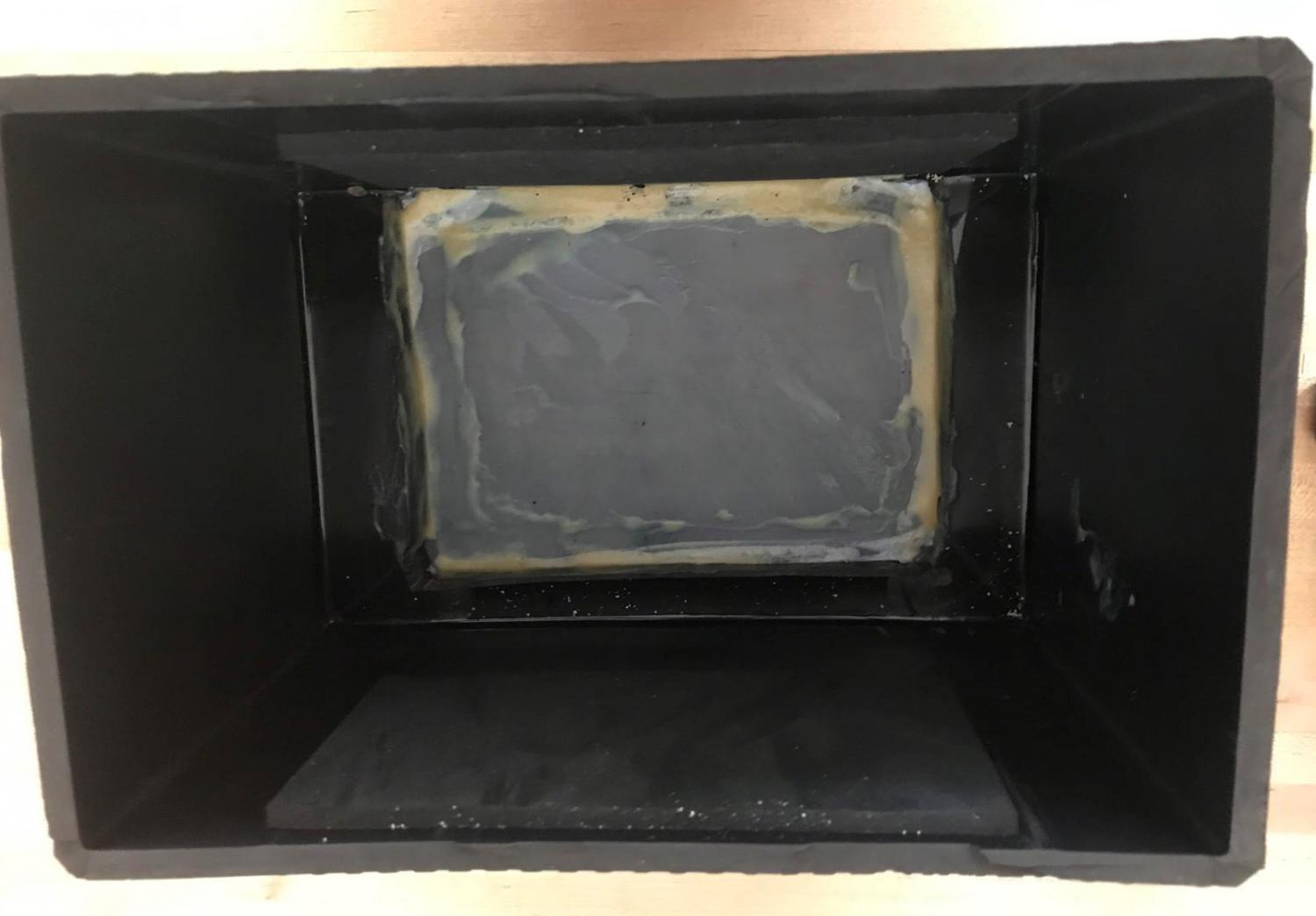

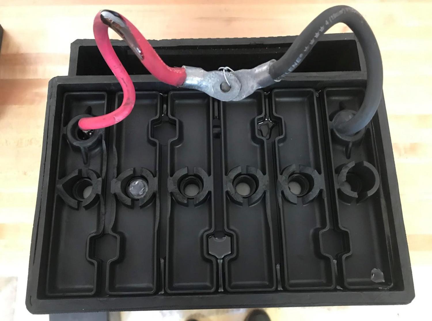

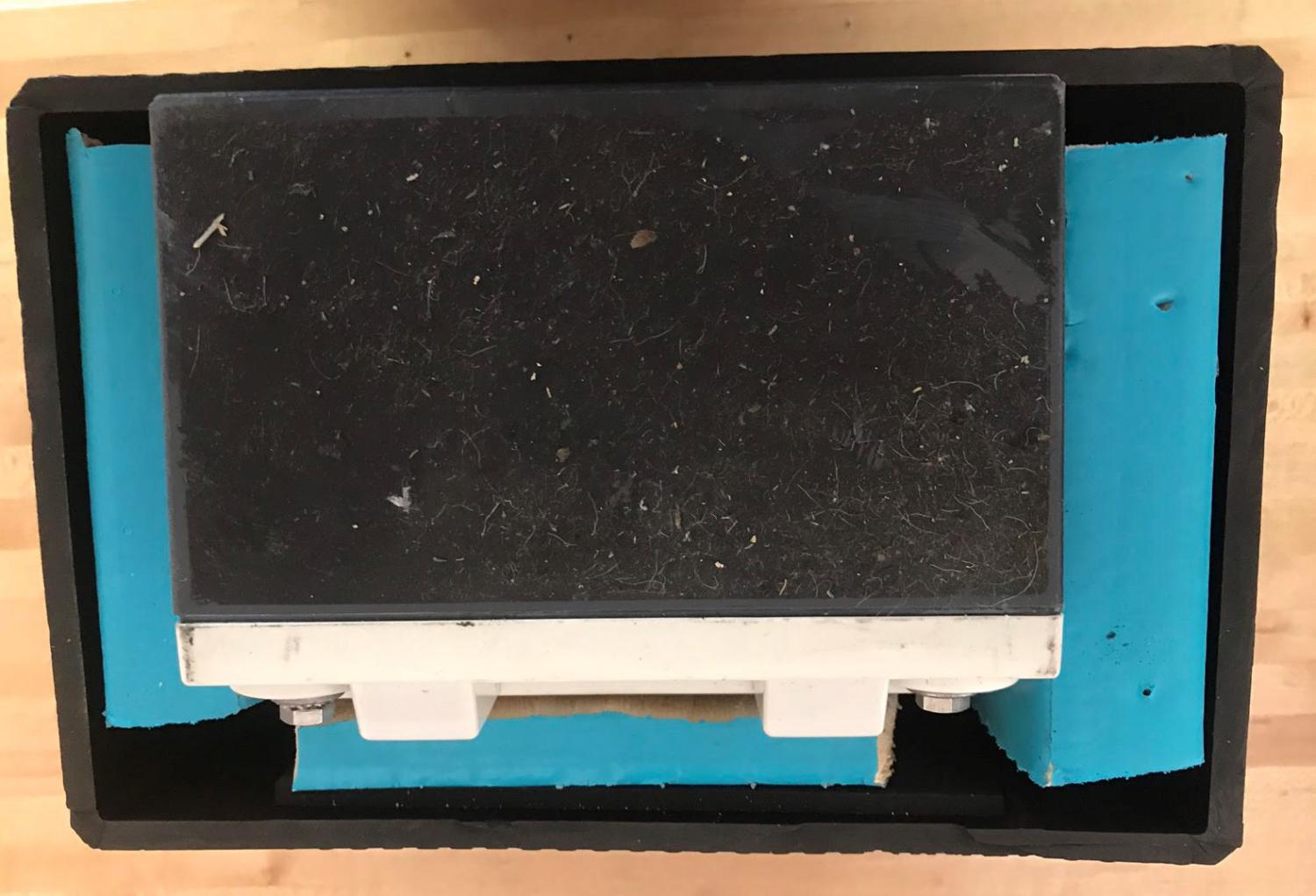

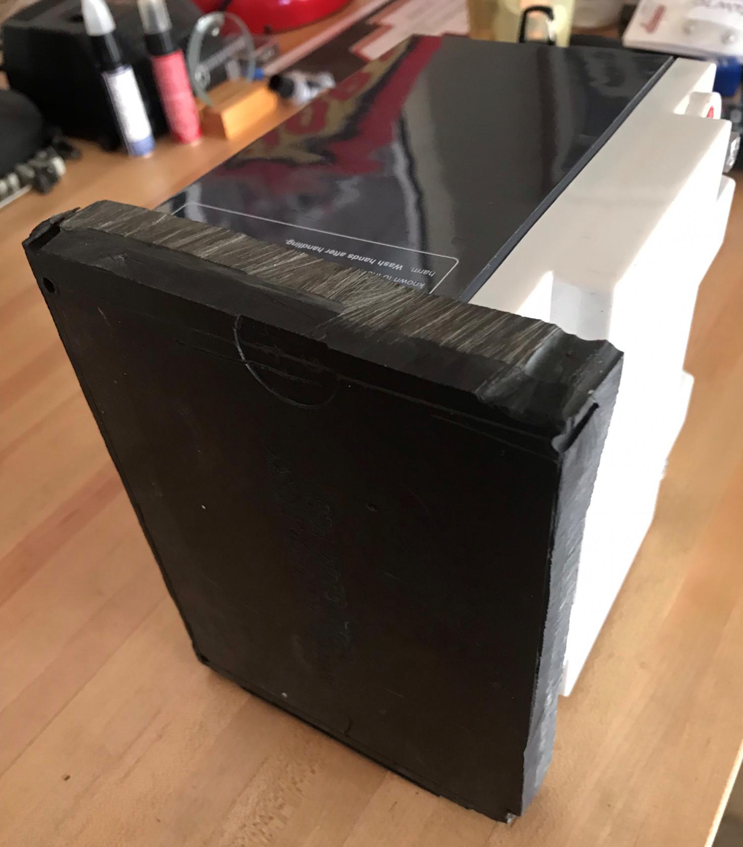

I cut the top of my R59 Restoration battery and then cut the sealed battery out of the base. I put in a new base and sealed battery, connected the leads and silicone sealed the top back on. It's good as new.

Here's the pictures.
