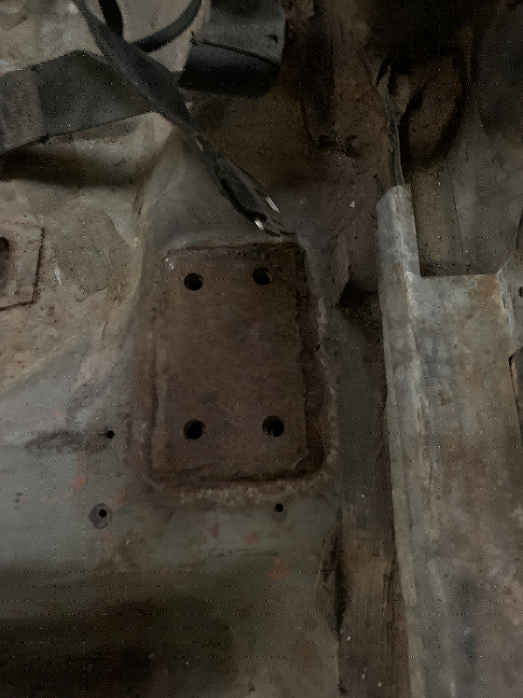

Originally the car had a four point roll bar, the original bolt hole pads are still welded in place in the floor. Is it possible to trace a vehicle in the SCCA venues based on said roll bar or vin number?

I believe you would need the cage number to do any tracing which sounds like it is no more... the number on the cage is what the different sanctions kept track of. They didnt really car about VIN. and a 4 point seems a little light duty for SCCA?

Here is a picture of the roll bar pads, still in place after all these years.

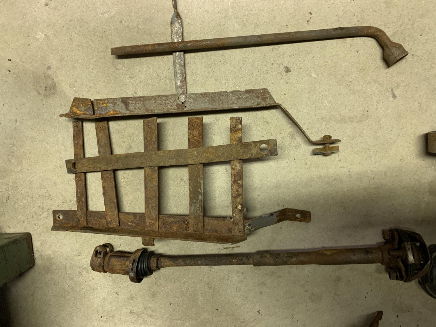

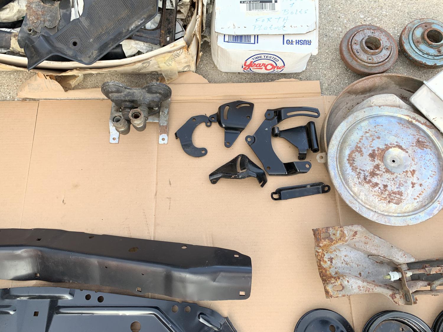

Here are a couple of shots of some of the original race car parts that were fabricated back in the day along with some of the aftermarket parts added to again either enhance the performance/reliability or dress the vehicle up during the time period.
Almost looks like two old aluminum bread pans welded together to create a fuel filter or fuel line cooling tank.
The front SS braided brake lines.
The M/T valve covers and unknown brand cast 12 bolt Chevy rear end cover.
Probably one of the most important pieces in the upper right corner of the parts picture is the dual oil filter housing with very large feed and return lines.
Looks like what appears to be a fabricated battery tray. Similar bar stock also holds the dual oil filter housing unit.

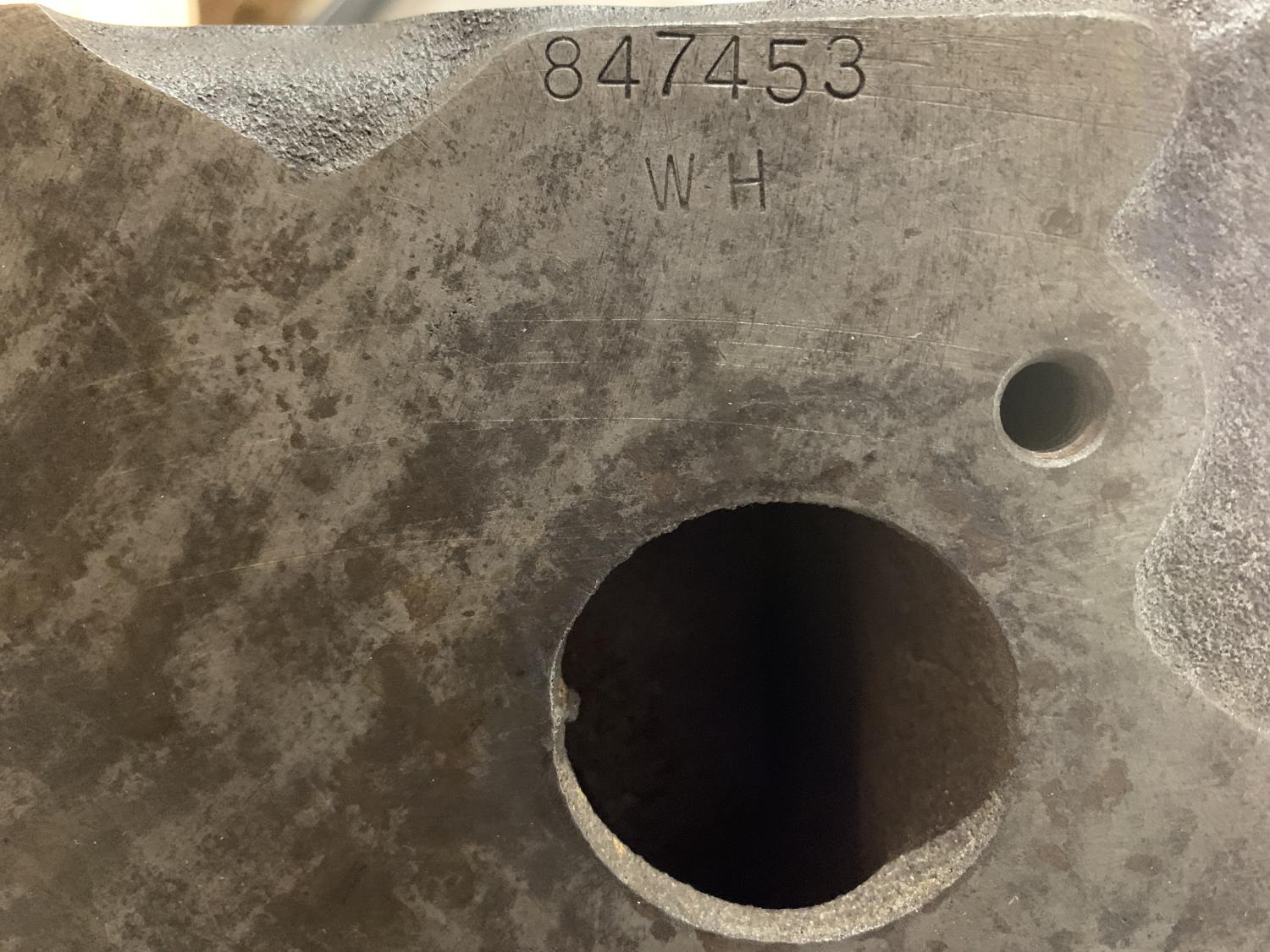

This is a very interesting part of the car and the history of what may have gone down back in the good ole days of parts and racing.
This is a 1969 400 block code WH Ram Air IV W/ manual transmission
The EUN is 847453
The date code appears to be I 04 9 so September 4th of 1969

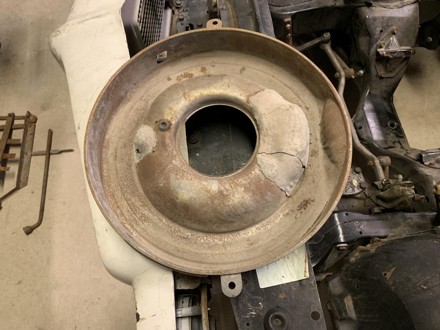

Here is a picture of the TA shaker scoop that originally on a Polar white car would have been blue, but was painted white and seems to parallel the pictures of the car on the racetrack and in the magazine article.
You can see on the upper right corner where the white paint has peeled away uncovering the original blue factory paint still intact.
