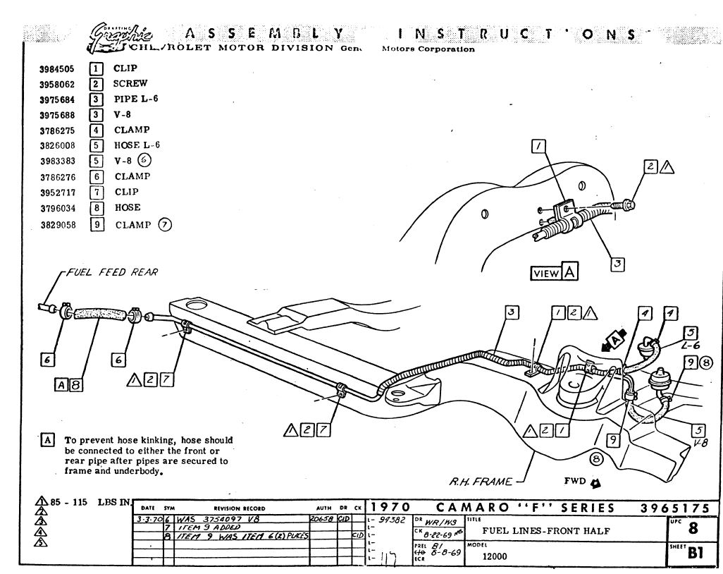

From the AIM....in the Classic Industries listing, that is actually the front and rear lines with the rubber hose missing. The L78's and Z28's had a single line. The photo of the car for sale is not a Z28 or L-78 so it got a return line also. By the way, the eBay listing has been ended early. Maybe he got upset that there was too much discussion about the fuel lines?

Kinda felt that may be the case. It was the first one to come up and since it seems the rubber hose was dependent on model too...never say never.
