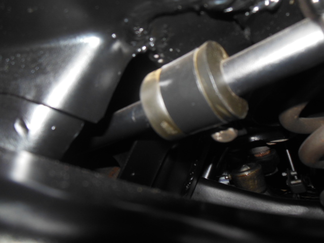

what was the purpose and correct location of this bushing mounted to the sway bar

I'll take a stab at it. Location should be tight against the inside of the bushing that holds the sway bar to the subframe on each side. Purpose is to take lateral force of the sway bar.

I like black poly for this.
