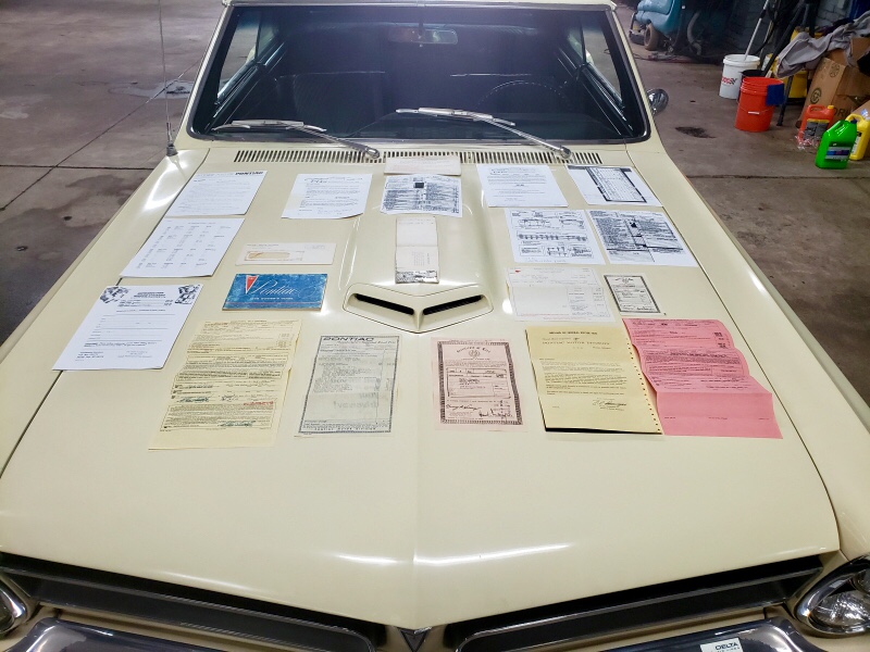

Default Orig Paint '65 GTO, Super Clean, Window Sticker

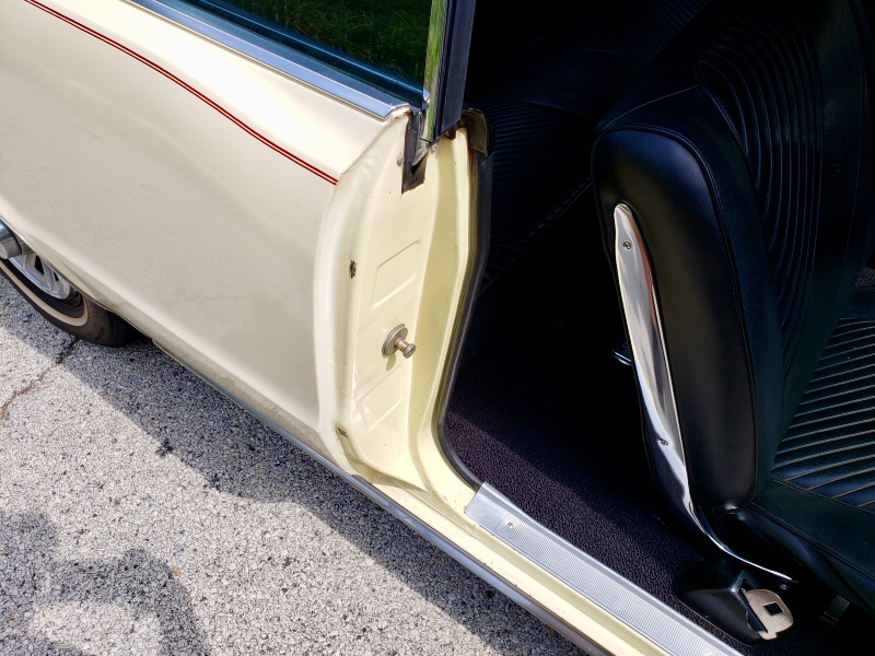

Cool car equipped nicely with A/C, AM/FM, and the no-business look of the 4-speed with no console. I'm digging the red pinstripe, too.

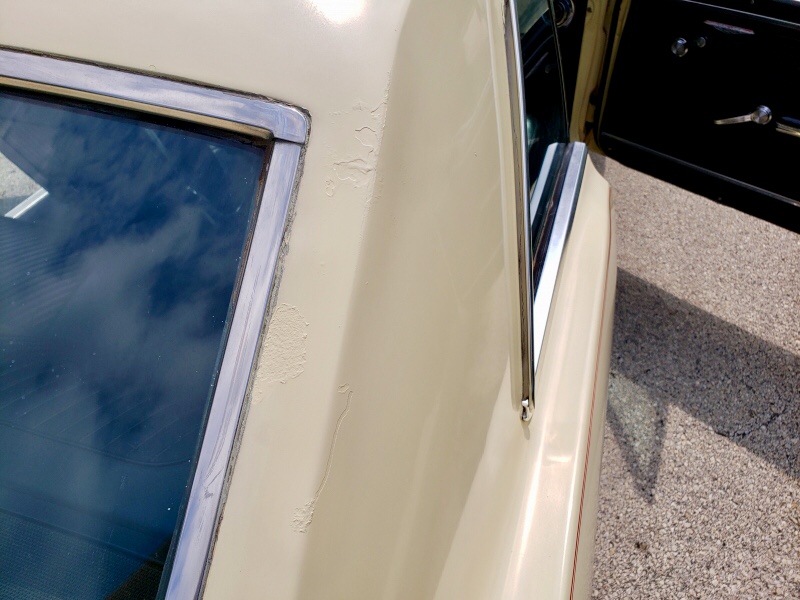

Seems like the original paint is in pretty presentable condition. At the $25k opening bid, I don't see how someone could go wrong.

That color looks great with the red pinstripes and redlines

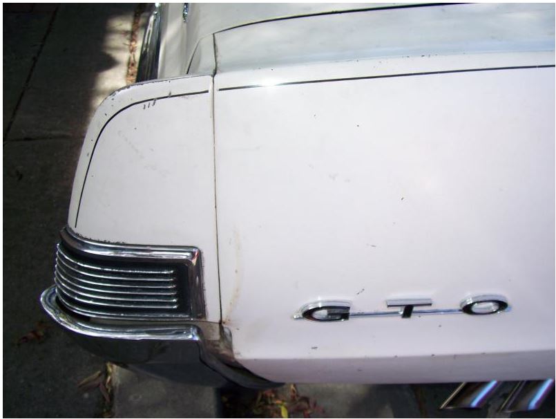

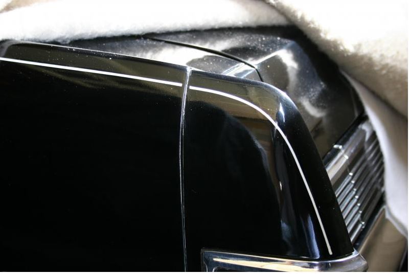

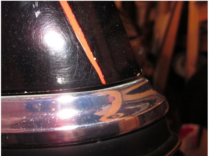

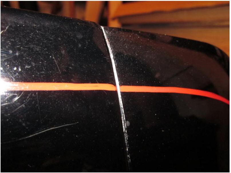

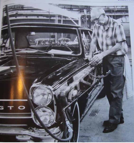

Pinstripe is not correct for an original paint car.
Fremont, Baltimore and Pontiac Mi built vehicles shown below:

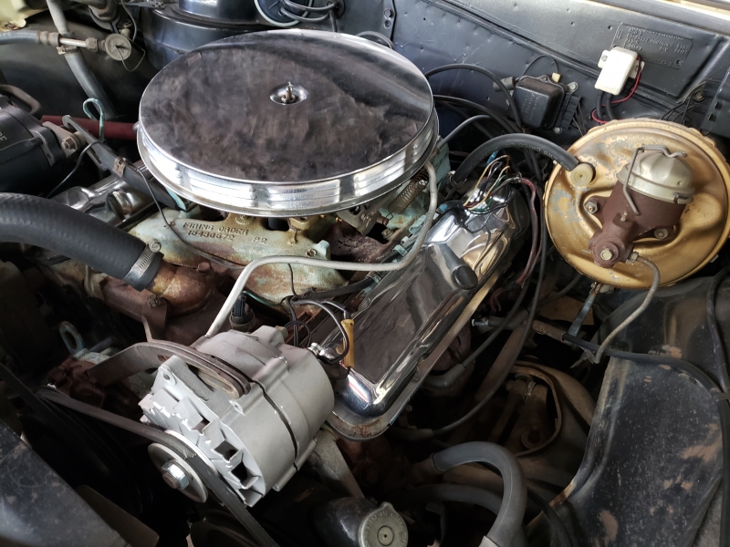

Would the pinstriping have been standard equipment from the factory? If not, this may have been added at the dealership, or afterwards. If so, then the seller's original paint claim comes into question. Nicely equipped car, regardless.
Disc brakes added in 2020??? So much for the "all original" claim

Pinstripe was standard with the GTO package; there was a pin stripe delete option available.

Thanks, Keith. I would guess if it had been deleted that would show on either the window sticker, or certainly on the PHS.

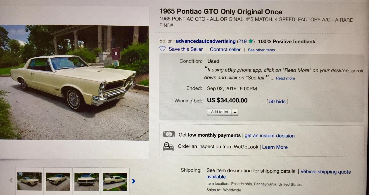

Default Same Same

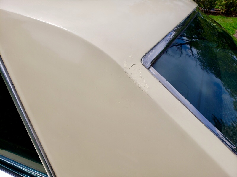

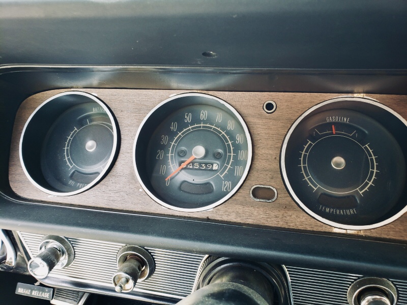

This ‘65 was on eBay about 10 months ago.
Started in Philadelphia, PA. and now in Woodland Hills, CA.
Still had its “factory” Power Brakes at that time.
If the car originally came with a pinstripe it would have been a single black stripe on a Mayfair Maize exterior with black interior.
At 104539 miles I question it being factory paint.
Still a very cool car with lots of documentation.
