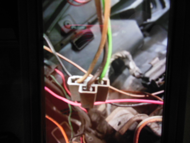

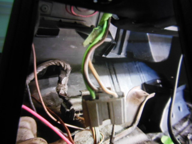

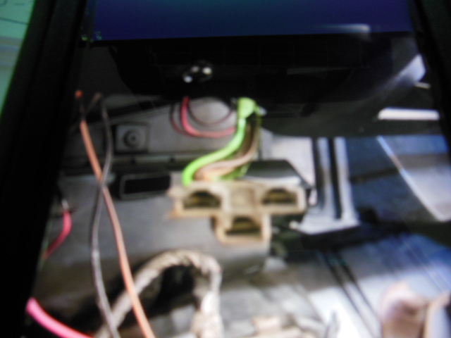

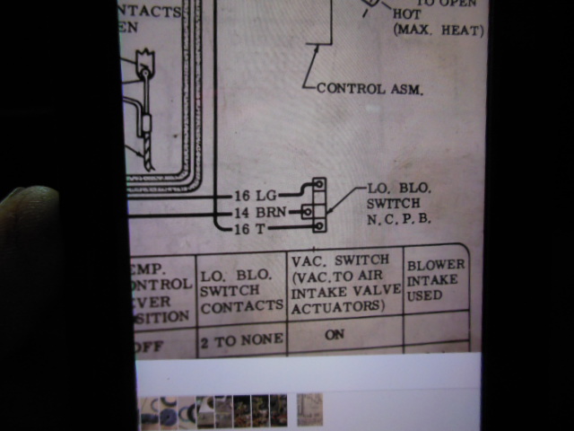

helping a friend out on a 69 Camaro with a/c and I can not figure out where the plug goes ?? its near the a/c control any help thanks

that connector plugs into the switch on the lower left side of the control head.

thanks I guess it would help if the switch was there thanks for the info

we found the switch in a box its all good now thanks
