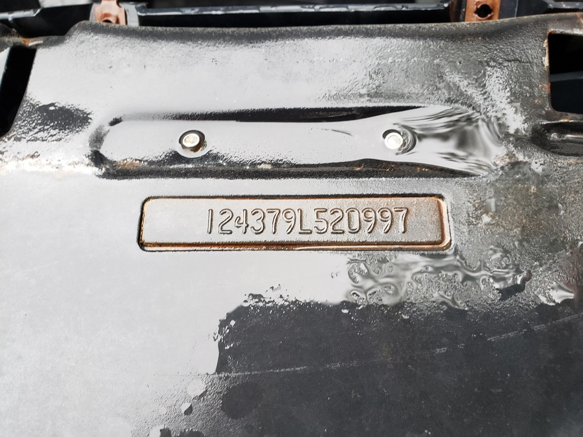

So the big question, as recognized experts of the high performance Camaros what is the consenses on what it is:
Big block missing original engine and trans
Big block clone (I hate the term clone)
Big block replica
I am including the vin and data plate so there will never be any confusion on this car being what I say it may or may not be.
Thanks folks!

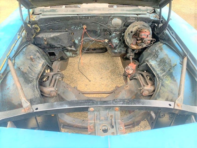

big dummy here...typo it is 3/8 fuel line.
thanks!
photo of fire wall, speedo cable on drivers side

Old 12-11-2019, 01:50 PM
x44d80 x44d80 is offline
Join Date: Nov 2001
Location: American Fork, Utah
Posts: 364
Thanks: 178
Thanked 86 Times in 45 Posts
I'll guess L-78 4-speed

Old 12-11-2019, 02:17 PM
m22mike's Avatar
m22mike m22mike is offline
Location: West of CAK
Posts: 5,001
Thanks: 766
Lightened up your picture a bit
The Following User Says Thank You to m22mike For This Useful Post:
chris slawski (12-11-2019)
Old 12-11-2019, 03:17 PM
chris slawski chris slawski is offline
Join Date: Mar 2012
Location: New Jersey
Posts: 398
Thanks: 185
Thanked 115 Times in 64 Posts
Talking
doesn't look any prettier though!

Old 12-11-2019, 04:44 PM
nova67 nova67 is offline
Join Date: Feb 2004
Location: Az.
Posts: 163
Thanked 20 Times in 19 Posts
Default 69 van nuys
Chris...can you measure the length of the speedo cable?
