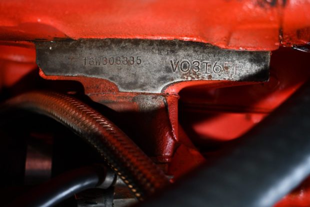

Scary reckless? Nice car, if it’s real.
Thoughts on that engine stamp and very fresh looking trim tag?

Originally Posted by L78M22Rag View Post
Thoughts on that engine stamp ?
I think the "EP" stamp looks a whole lot more faint than the "V03I6"
I've seen a few like this before.Look how deep the "VO3" side is,as if they leaned heavily on that one side while stamping.

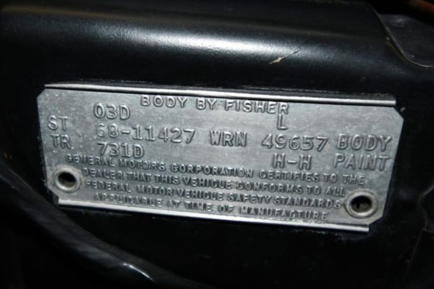

Build sheet shown in the description is not for this car. Color shown as Cranberry Red, a 1972 color.
Old 05-02-2020, 12:38 PM
Posts: 21,008
Thanked 3,705 Times in 1,491 Posts
Code 75 started in 1970.Good catch.
