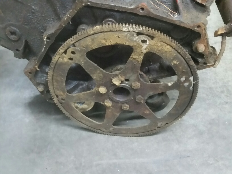

I bought a '69 427 last week and it has this flex plate on it. I've never seen one like this on a Chevy before. Anybody else seen one?

I think it’s for a old cast iron Power Glide, 55-62.

What is the engine code on the stamp pad

LC

May be from an air cooled power glide ...

Its a cast iron Powerglide flywheel. 1955-62
I just googled it and the images are the same.
https://www.southeastchevyparts.com/...62_p_1346.html

Thanks guys. I hadn't seen one before and didn't know if I had something special or if it was junk. I don't think I'd be using it with a 427.
