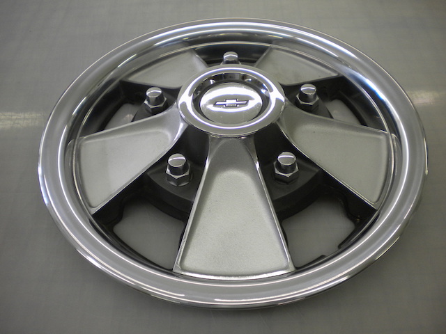

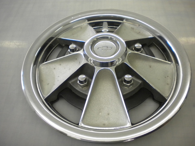

The cap on top is the '67-'68 version, bottom is '65-'66. Primarily the '66 cap has smaller vent holes and the center cap appears separate from the spokes while the '67 cap has larger holes and the center cap appears molded into the spokes.
I believe the painted spokes came in '69 or '70??
Willow green is a great color, really pops in BC/CC!!
Bill W

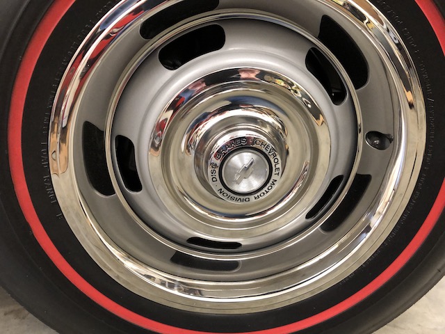

Novas did use the "DA" rims on the 4 piston calipers. If you look at the rim on a "DA" Chevy ll
you can see the bulge the rim has to clear the caliper. the DG does not have that on a
chevy ll.
Here is a DG rim another member is selling...
https://www.yenko.net/forum/showthread.php?t=159382
Here is a DA rim that Tony is selling, another member here...
https://www.yenko.net/forum/showthread.php?t=148738
