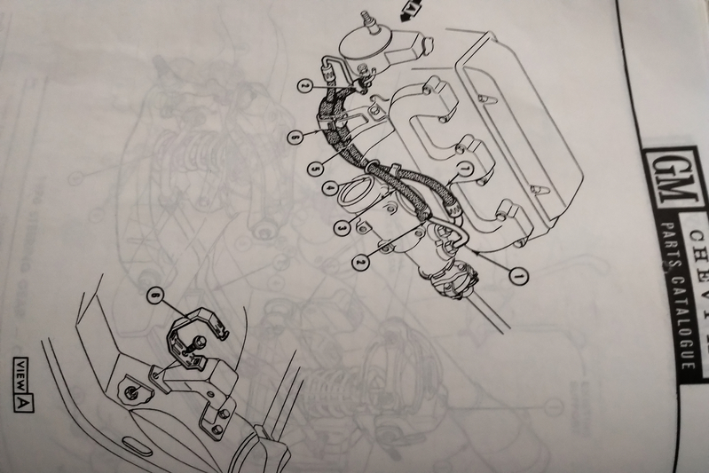

This pic is from the gm product info. program.

That looks like what I need except it's a small block. Probably the same as big block though. Thanks for all he feedback guys....

You will need the clip that attaches to the lower motor mount bolt to keep them in place.
