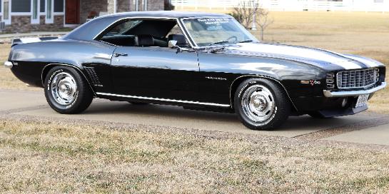

I just love a Black 1969 RS/Z28!
http://www.sandsclassiccars.com./196...oZ28Black.html
The good -
Car has a McNeish report -
Real tag never removed
10 10
NICE original Deluxe interior
BV 4.10
Born with M22
618 V0313DZ
The negs. -
RS equip added -
McNeish report makes no mention of ZL2.
report states Numerous fastener/details/small component issues.
IMHO the 89.9k price would be FAIR If it were a real RS with ZL2 given Z28 M22 and Z87, however what the heck do I know?

No pic of the engine stamping. Jerry says the trans is orig to car but nothing mentioned about engine and rear.
I like the Black one Charlie sold. This needs some sorting out.
