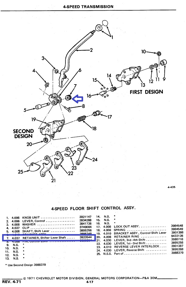

Hi Guys, wanted to know what this MUNCIE Spacer or Bushing is called?
I have a shifter assembly missing this and want to buy it, looked all over eBay but no luck. It is made out of a hard type of plastic.

it is a rubber donut that goes on the main shaft bushing between the shifter and the mount bracket
originals are hard to find because the rubber gets hard and breaks
I don't know if anyone repops them
Some people make new ones from rubber grommets but its not the best solution

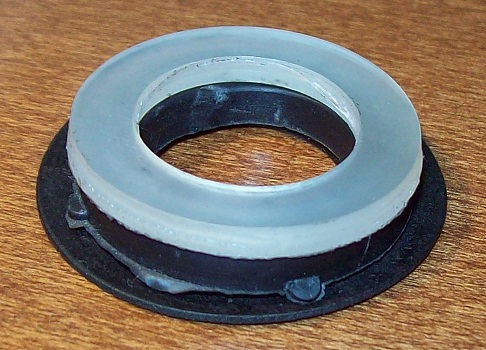

I made a spacer donut that fits perfectly myself, bottom is a thin rubber washer, middle is a outside hose rubber washer and the top is a plastic nylon Oil Pan washer.
The fit is dead on in thickness and the center hole fit is dead on.
Better then having nothing.

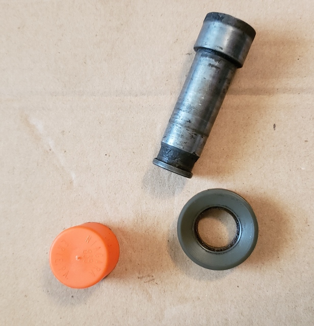

this is what was left of mine after it dried up LOL
the orange dust cap is fine

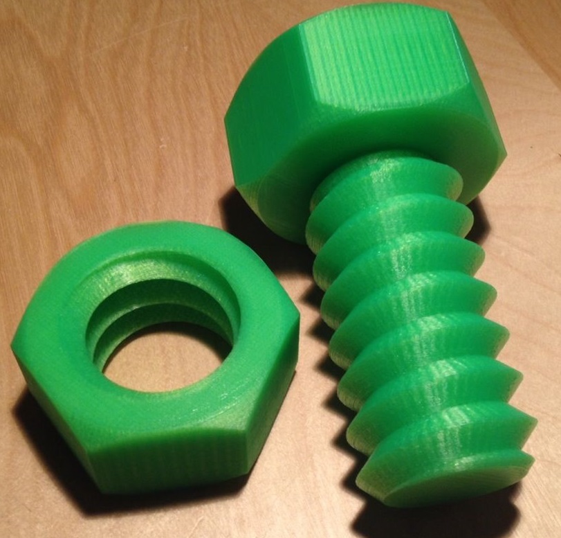

Someone that has a 3D object printer should make these easily buy replicating a real one IMO (Do a color like this so you can keep on eye on it)

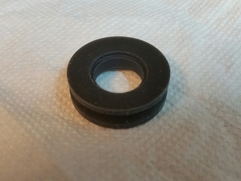

i pulled some dimensions off an original one
