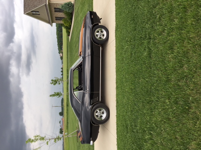

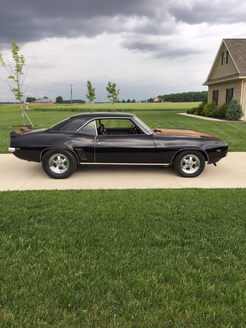

Here's the look on my 1969 Camaro. These are a borrowed set....I liked the look so bought a pair. FWIW my front springs are not stock.
The Following 2 Users Say Thank You to R68GTO For This Useful Post:
scuncio (11-26-2019), TheNovaMan (11-27-2019)

I am not sure why some pics come out rotated (sometimes up side down)
Try this:
