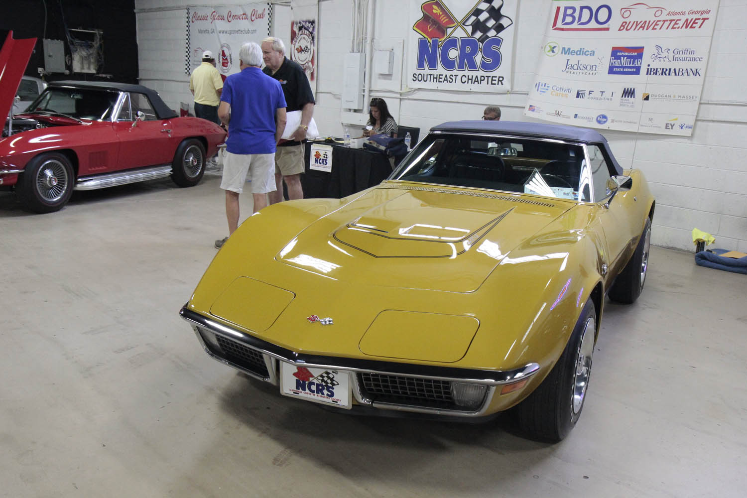

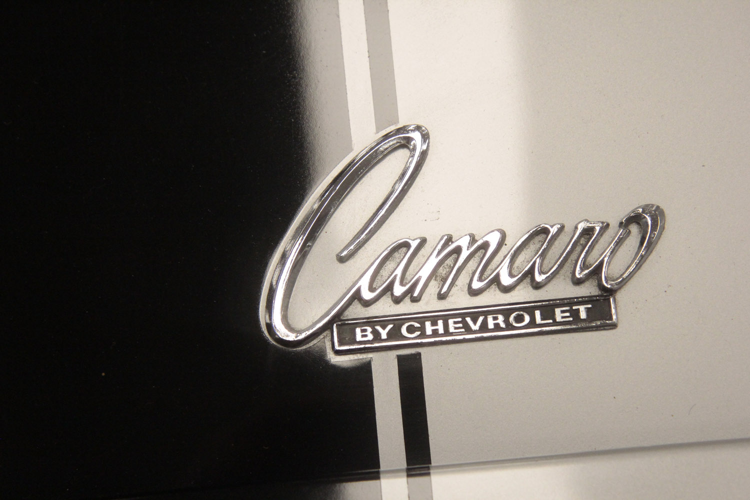

Default Factory paint, wet sanded & buffed?
I know there are folks here who have actually worked(or still work) for GM. Out of curiosity, back in the day(and even now) do new cars get wet sanded and buffed at the factory?
I have seen many pictures over the years of cars being painted at the factory but I've never seen a picture of a car being sanded and buffed at the factory.
Thanks!

Base coat/clear coat - no
High solid enamel - not as part of the production process. There may be some sanding or buffing during a repair attempt of a specific area.
Lacquer - on some high end products there may have been buffing as part of the process but generally no, not since the 1930s or 1940s.
I'd say it is just too slow and labor intensive for the high volume mentality of the 1950s and 1960s.

I appreciate all the replies. That explains why I have never run across any assembly line wet sand/buff pictures.
Originally Posted by 70 copo View Post
OP
Give me a date range of interest please.
Basically I have always been curious.
What caused the thread was I have purchased a '69 Firebird and when I get around to the restomod I want to paint it Verdoro Green. I would like it to look like a 1969 paint job.
I see a lot of restored cars that just don't seem to look like they did back in the day and I was wondering if it may be the paint finish(and radial tires) that throw off the look.

Corvettes were polished. Because the Reflow oven could not get hot enough to actually melt the paint as the steal cars had. And if they made it hot enough the fiberglass would melt.
