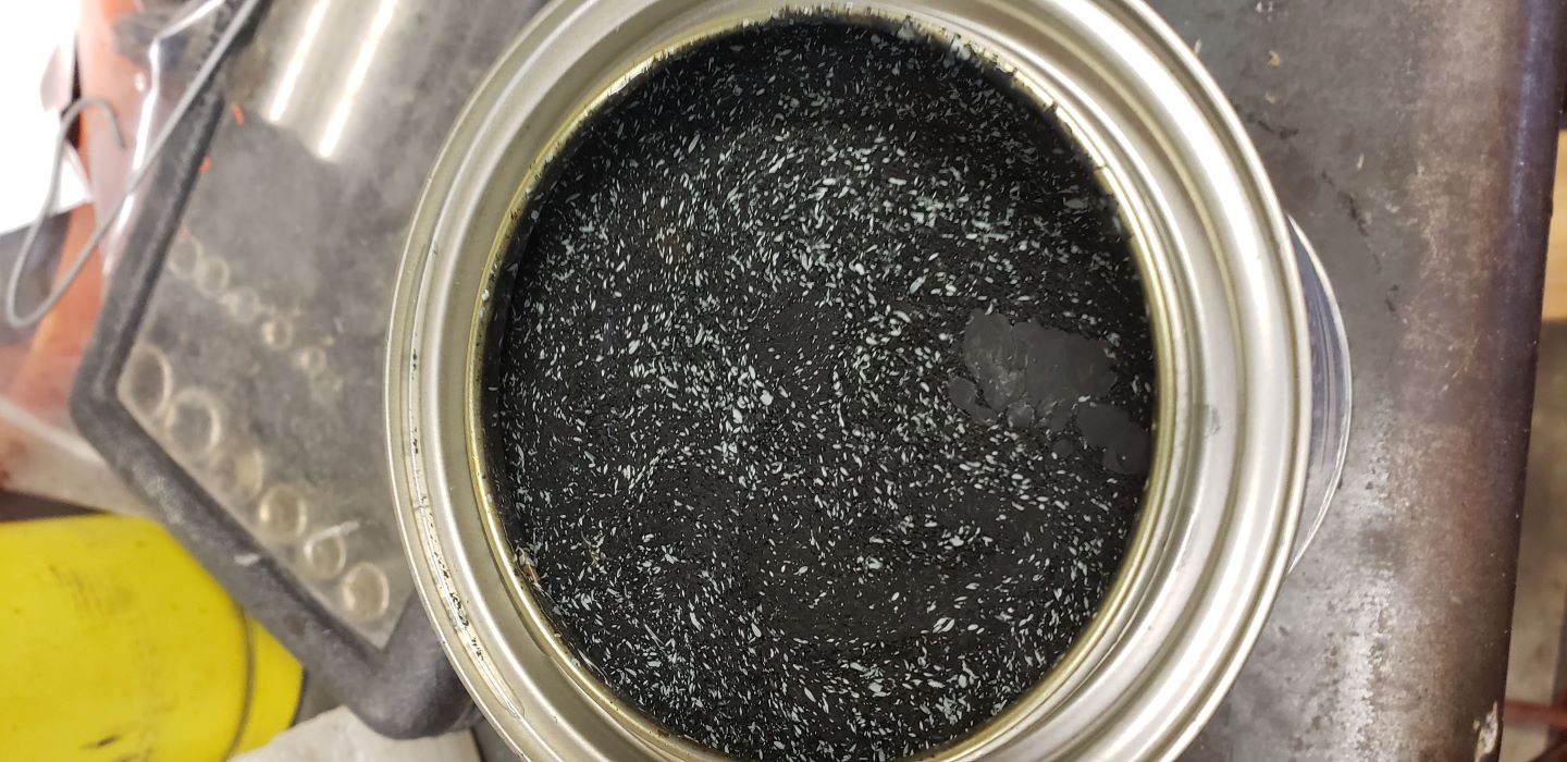

Hi all,
I am needing do my trunk spatter in my 1969 Nova ss. It is the black with aqua. I bought a quart of the product from "The Parts Place" (about $70).I
I am trying to figure out the best way to spray it an get good results. I have heard a primer gun, but I am afraid it would bread up the paint globs to much. I have also heard about using a undercoat gun? Not sure how that would work. Those guns are meant to attach to a bottle.
Does anyone have any tips on doing this or know of any good articles or posts?
Thanks
Kevin

Last night I did a test spray of black with aqua trunk spatter from "The Parts Place" using a Wagner Power Painter.
When gently stiring the product, you can really see the green specs, and the color on the paint stick looked close. I have a sample piece of metal from my original trunk to compare it too. i do think the specs are a little smaller in the new paint.
It did "not" work. It came out looking like blackish gray undercoat and i could not see any of the green specks. My guess is the way the electric power painter's small piston throws the paint, it probably breaks up the green specs.
Next I will try my primer gun.

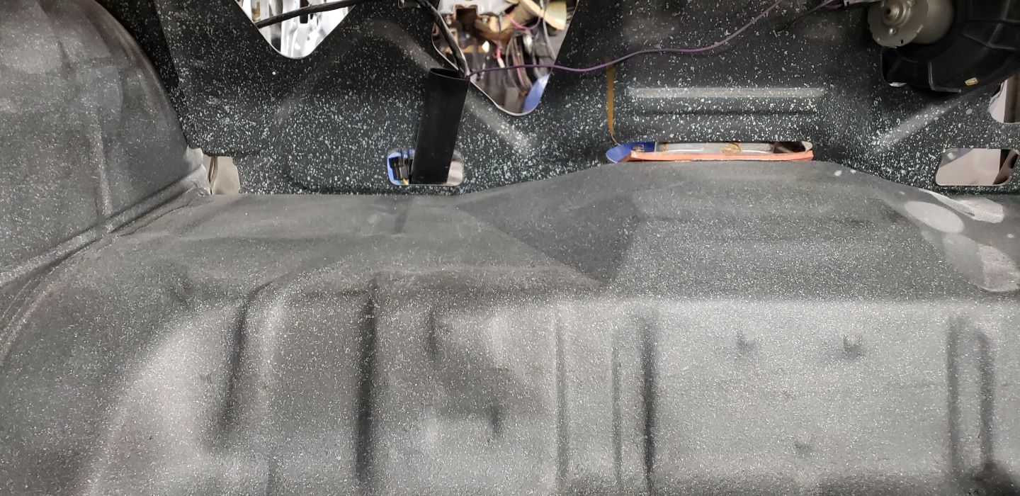

Ok, It's done. After trying various methods, I got great results by using a soft foam roller from Home Depot and foam brushes. When doing it, I used the foam brush to do corners and other areas the roller will not do. Just dont press hard on roller or brush. If you do, it smashs the aqua specks. No bid deal, you just roll over it again. It does not show roller marks. I have samples of the original truck floor spatter to compare it to, and I am very happy. Doing it this way also eliminated me from overspray. Like I said in earlier post, i used: black with aqua. I bought a quart of the product from "The Parts Place".
Before breaking out your spray gun, I recommend buying a cheap roller and doing a test.

I'm not happy with my latest black/aqua from Parts Place. I ordered a second can and found the specs to be just as small as in the first can. It is no where near the base color or size spatter of the original section on the trunk divider, which I left original. (Photos below)
Sad to see the parts place stuff look no better than dupli-color buzz bomb. I've had good luck in the past with this product.
I did get a return call from the Manager confirming nothing had changed in regards to the manufacturer or product, very helpful, but no solution. Sprayed some out of a schutz gun with the same results. Small specs cannot become big spatters!
