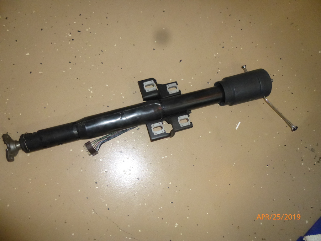

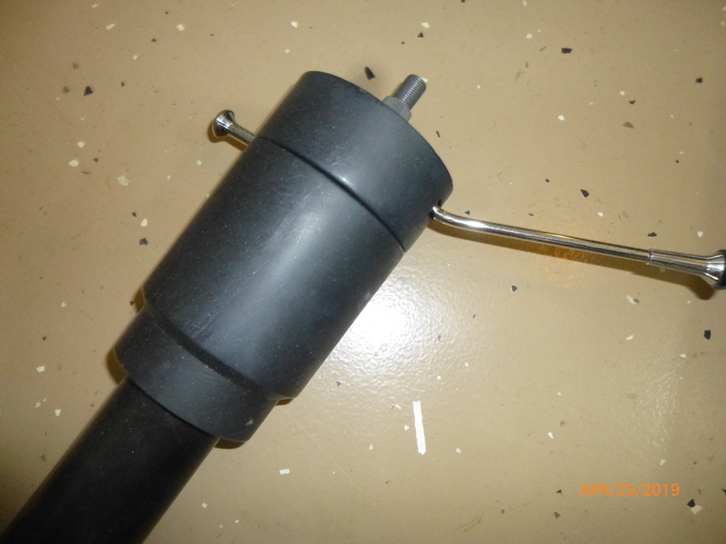

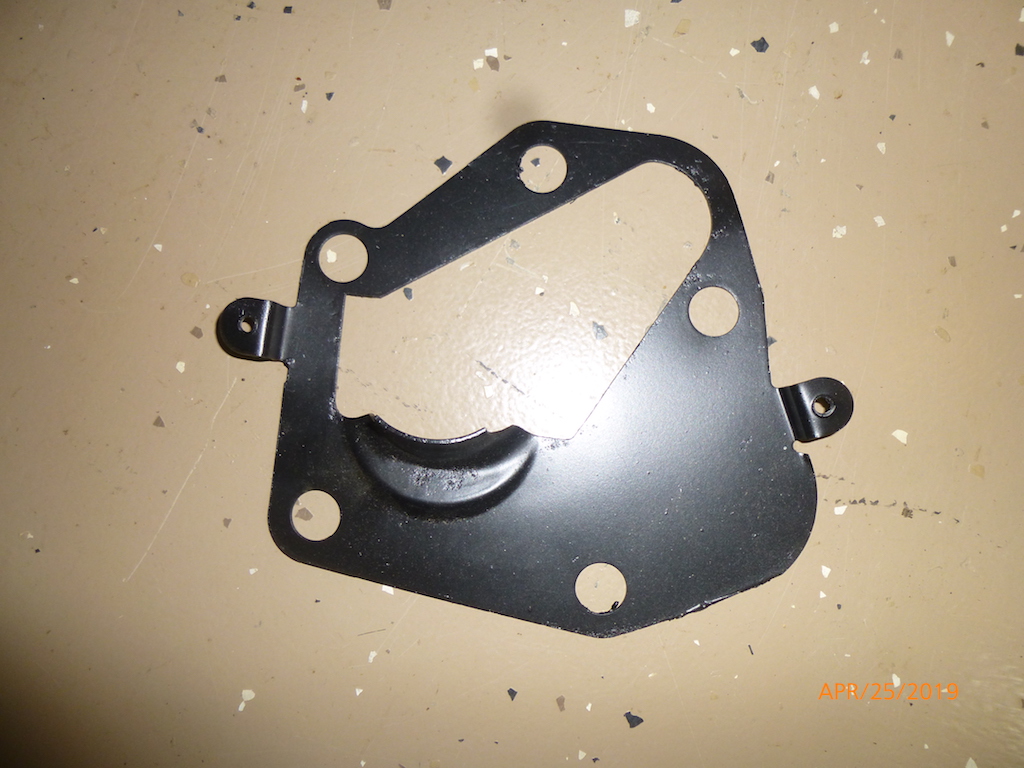

Can anybody ID this column? I was told 67 Nova but I have doubts.

Didn't the '67 Nova have the long shaft that went into the steering box?

I know 66 the steering shaft is in the steering box , I believe 67 was the first year with a rag joint

No rag joint in a 67 Chevy ll...the shaft comes off the steering box as I just did one. 66 shaft
comes out with the box as 67 does not. Column pictured is not a Nova column as it has
provisions for a rag joint. 67 Nova has a clamp/bolt to attach to the steering box.
Looks like a Cutlass column? The 4 way flasher is long as the 67 Nova has a stubby.

Quad dash mount also floor plate looks 67/68 B-Body?
Compare w/ that Tilt unit you sold last year...
