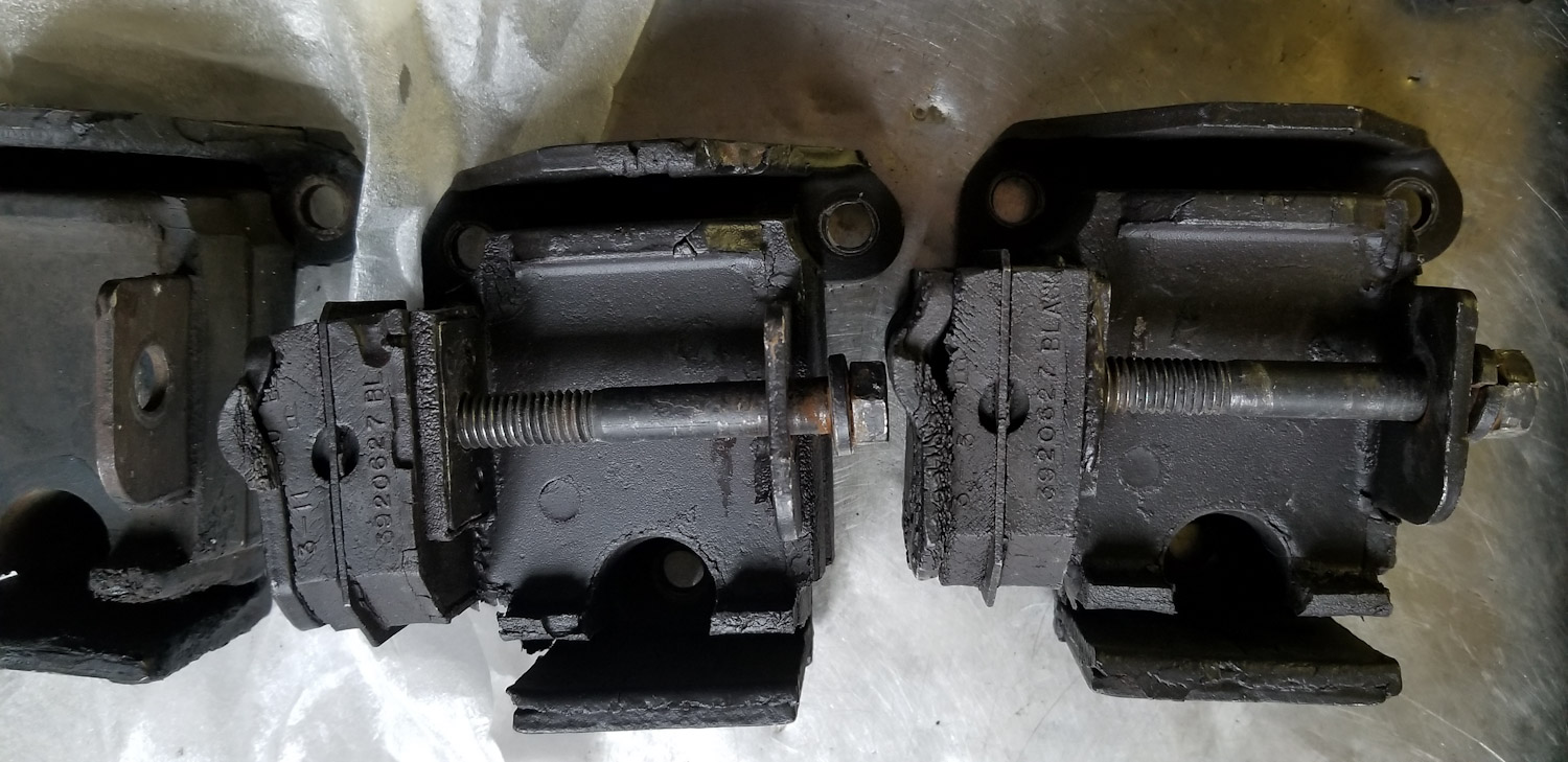

Here are a couple sets of these original mounts that physicslly look identical in shape, but the numbers are different.
The 2 with the bolts are a matched set from one vehicle, and the ones without bolts are likewise.

Very nice...........thanks for the pictures.
We know that the early assembly line mounts had part number 3937930 on them only, mounts were available with both 3937930 & 3920627 part numbers on them and mounts with part number 3920627 only.
It appears that the part numbers on the mounts went through a transition period from the 3937930 to 3920627 mount. It implies that when GM released a newer version of the 3937930 mount they placed both part numbers; original 3937930 and the revised number 3920627 on the mount for a period of time which eventually lead to the mount being available with part number 3920627 only until it was discontinued on 4/70.
