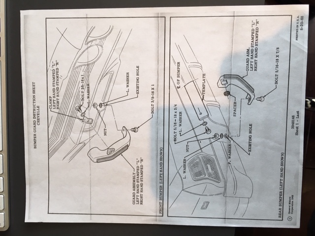

Default 1969 Chevelle Bumper Guard Install sheet
Hoping someone could use this...

The rubber guards are always tough to find....plus you never want to misplace or lose the front bumper guard clamp.

I just posted the instruction sheet as reference...i don't have the guards.
