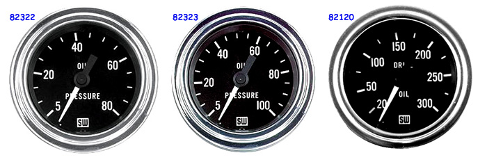

How or do the new greenline gauges differ from vintage late 60's gauges? Also what about the Deluxe line, same question. I'm asking about the 2 1/16 and 2 5/8 oil pressure and water temperature. Did the Yenkos use mechanical or electric gauges? Thanks

These are the repro's, they have obvious differences to the originals - JoeB prob has plenty of NOS one he can post pics of....

Any one have an opinion on the deluxe gauges, old vs new? Also were electric gauges used much back in the day? I remember the early 70's here, Sun tach and SW oil and water gauge were standard in lots of cars. As I remember everything was mechanical. Did Yenko use mechanical or electric gauges as an option. How were they routed through the firewall? Drilled a big hole? Hoping that Joe, the gauge guru, pops in.

As far as I know, Yenko only used mechanical SW gauges. As with anything, if you're super fussy and are determined to find differences between old and new I'm sure you can... but I personally think they did a pretty good job with the new ones.

Did they put 2 5/8 or 2 1/16 gauges in the Yenko's.

Both 2 1/16" and 2 5/8" were used. In 69 they installed these 2 1/16" pre-packaged triple gauge assemblies in many cars. Dixco Hustlers on the bottom as used in '70 in the Deuces.
