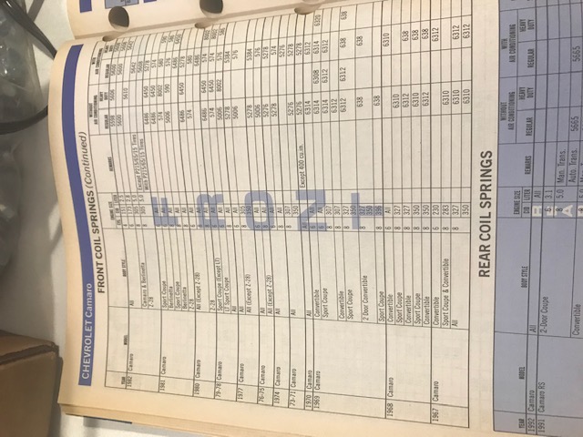

Need to find out the correct front coil springs for a 69 non air BB. There is a Moog or Napa part number that is right on. Used them before but cant remember the part number. Maybe Brian H. will chime in ? I am sure the Supercar Workshop uses them. Thanks John

From an old Moog catalog dated August 1993 reads # 638 w/o Air Conditioning which crosses to NAPA part # NCP 2771154 $85.00 cost and still available.
