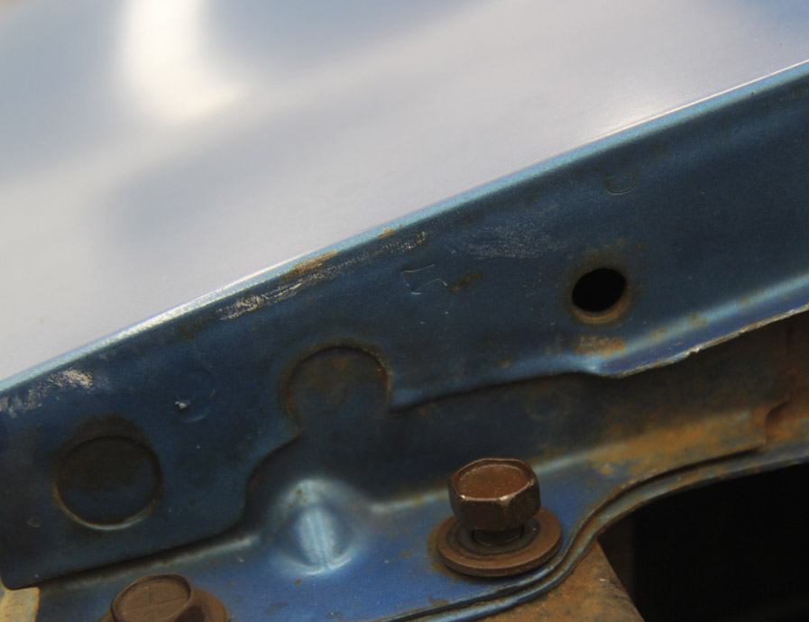

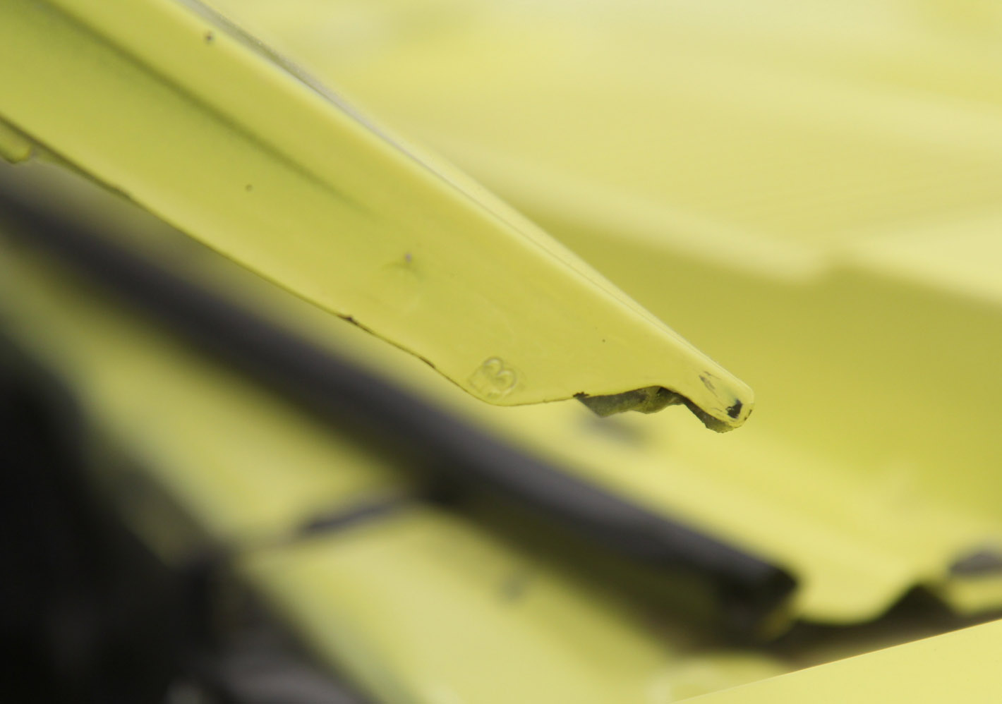

6A11976.
June something 1976?
It's only Orig once
waste all the rest.
1978 Y88

that is not a date code...
The fender and hood dates are typically only a number corresponding with the week of the year.... 53 on the hood is because of how weeks fall.

who or where in the process was the date/week stamped on the sheet metal. And what was it's reason for doing it?
67 Z28, 67 RS/SS 396 Canadian, 73 Camaro Z28/LT Carolina Blue
Old 01-08-2019, 03:47 AM
Kurt S Kurt S is offline
Location: Ann Arbor, MI
Posts: 3,147
Thanked 908 Times in 397 Posts
By the stamping plant.
For traceability.

You can see accident replacement too.
