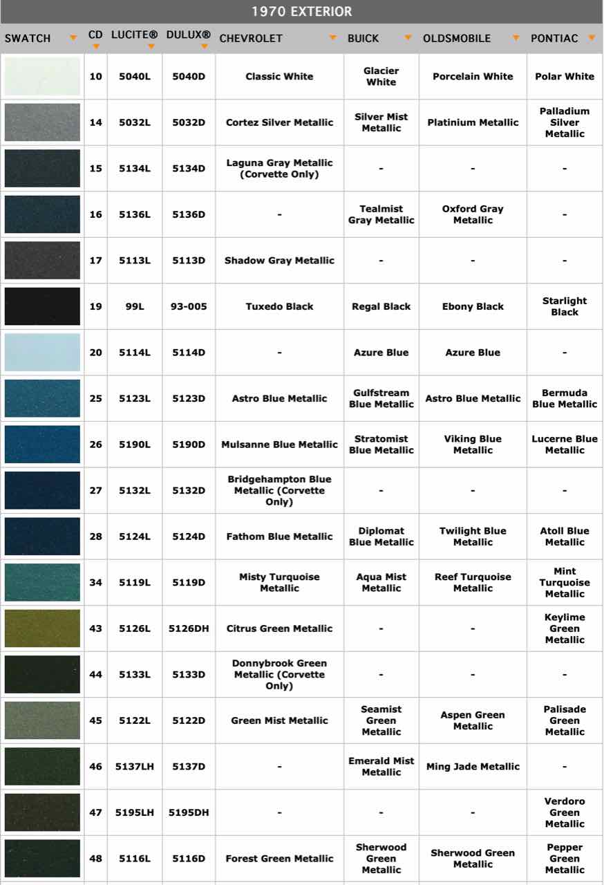

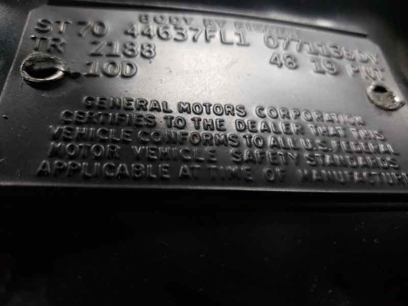

Default '70 Skylark GS Stage 1, #s Car with 4-speed, AC, Great Colors.
Pretty rare car to begin with (1 of 664 4-speeds) and apparently one of only 54 with the 4-speed and factory air. Great colors too...I have the same Pearl interior color in my '70 Chevelle and just love it.

The colors aren't original.
It didn't have a white vinyl top, but was two-tone with a black top.
And the interior was black too.

It's all right there on the sheet...
188 - black interior
48- Sherwood Green
19 - Black Vinyl top

D99 on sheet indicates two-tone paint so roof was painted black, not a vinyl top.

19 indicated Regal Black paint.

Nice close up of the trim tag BTW....
yes you're right
the original combo would be my preference for sure
