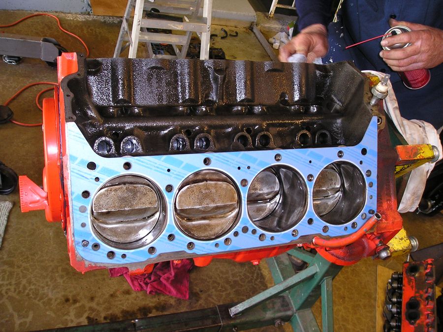

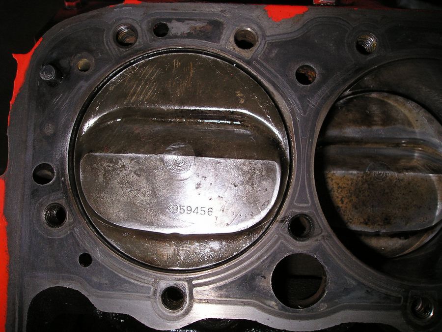

To the best of my knowledge the LT1 was a standard bore 11:1 high dome piston....these pics are from my 70 Z28 engine rebuild. Note part number stamped on the top of each piston...

so that i am clear
for my LT1 deuce
1) the pins will be press
2) the pistons have to be for LT1 sbc NOT 302 sbc
3) pistons i need are GM#3959456 or GM TRW L2304 replacement?
FYI All of your pistons are in backwards. Im guessing including the Thrust side of the rods...

hi
kenmaisano post comment
this is not my deuces engine pictured here.......picture was posted by another site member to show piston part numbers
