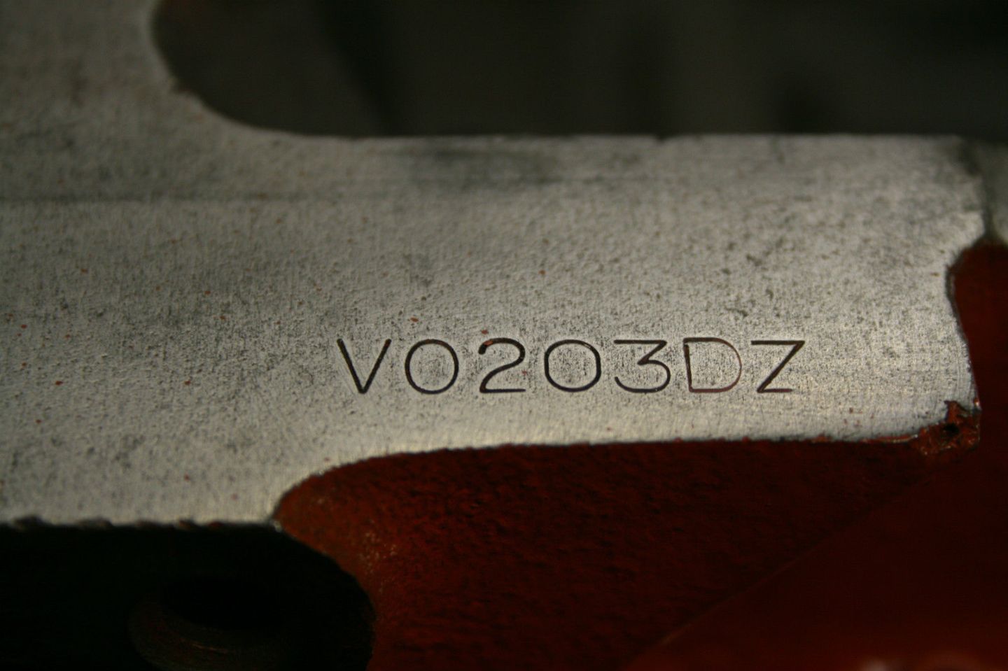

How does this stamp compare to other 69 camaro fonts ? thanks.

Matches with a different example of the same date.

Look's like a good stamp!!

No broach marks, looks more recent than a 50 year old stamping. Characters might be right, I wouldn't know. I say, no es bueno.

Looks good from the picture
The broach marks don't concern me, if standing in front of block they are visible.

I like It.

It's real.

Here's an original for comparison. I have several and it's dead on with those as well.

Curious if any of the restamps get that 3 or Z right.
