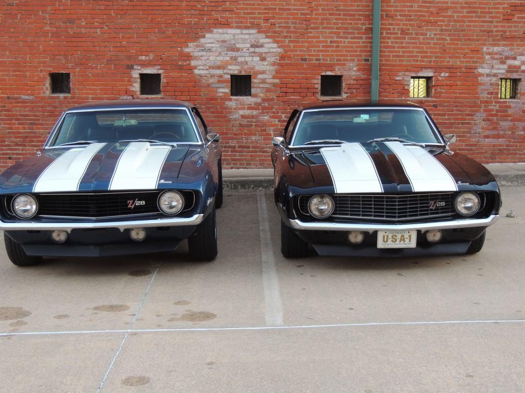

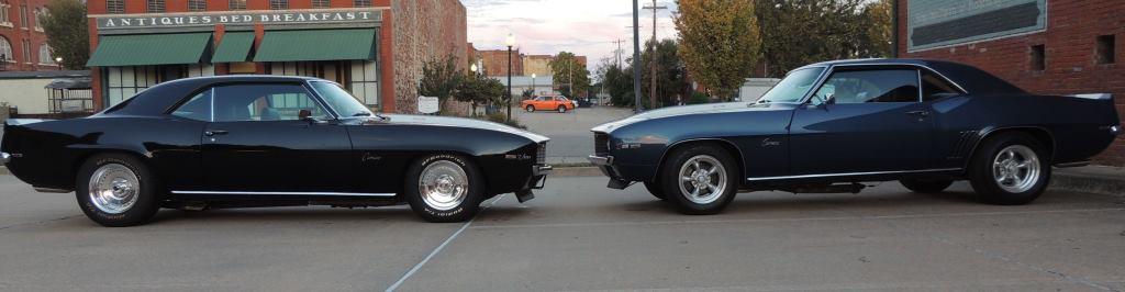

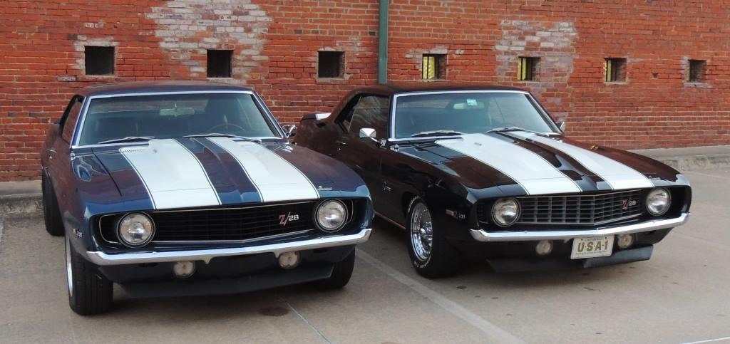

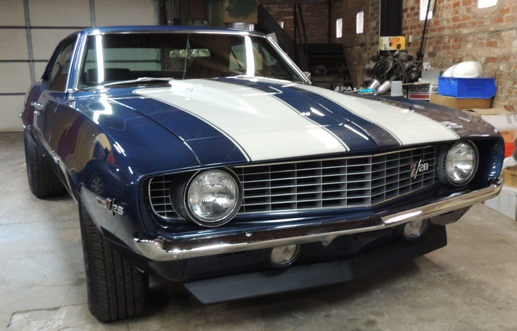

Pics of the two cars attached. On mine, one is with flash, and one without. The flash shot makes it look almost too light, but I am very happy with the color. I think Rick's looks way better with a silver grill.

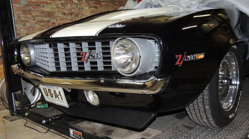

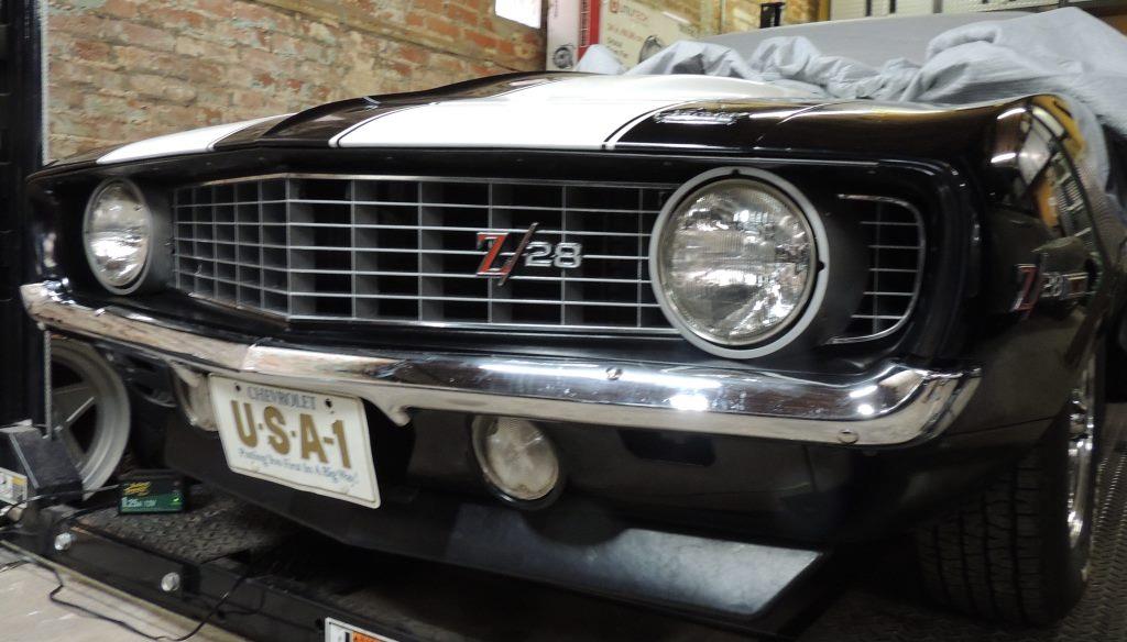

Couple of before shots.
