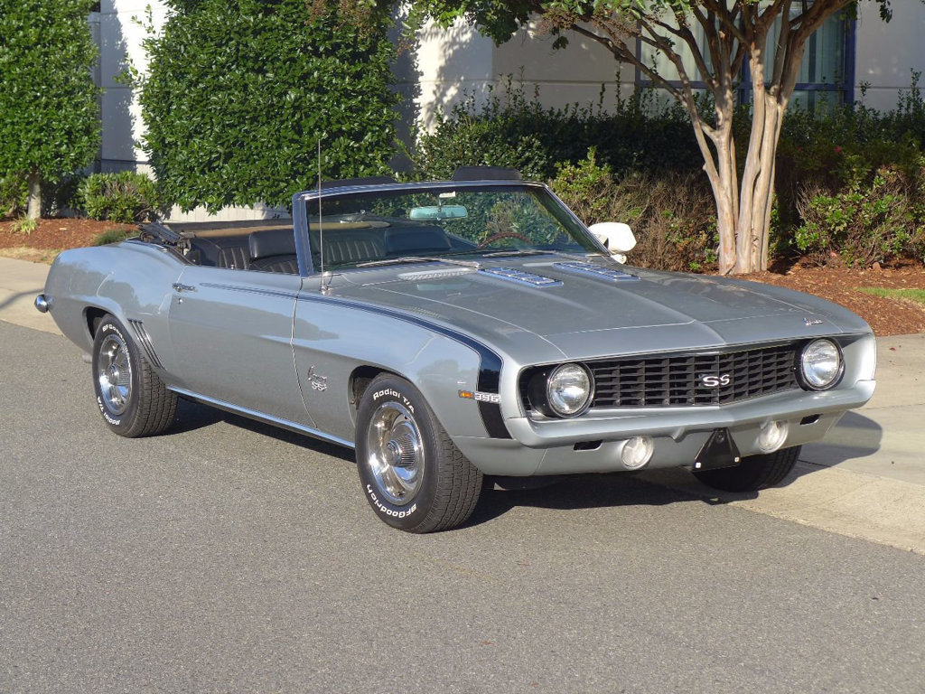

I recently purchased some Lemans Blue PPG (code 71) paint for my 1969 Camaro. The color does not appear to be correct based previous cars we have painted this color. Does anyone have any ideas what company has the best code 71 Lemans Blue paint that we can look into? PPG has changed the formula over the years and the color does not look the same. Any advice would be greatly appreciated.
Attachments - The Supercar Registry used-1969-chevrolet-camaro_ss_convertible--12308-15619172-8-1024.jpg IMG_7207.JPG
