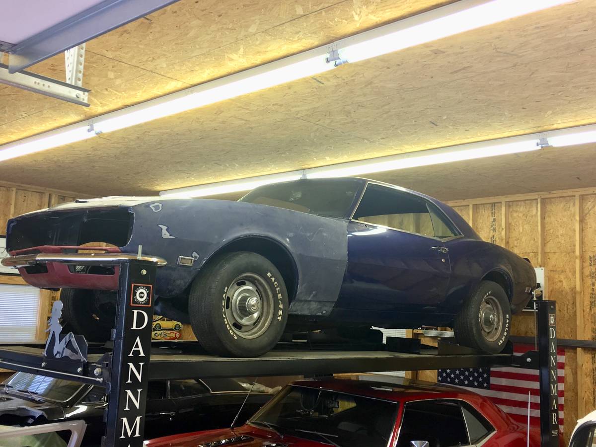

I believe the car to be a Z28, called a local friend who has had a few 68 Z's and he too said he knew the car and believed it to be a Z28.
I can go look at the car and take some detailed pics if anyone is interested.

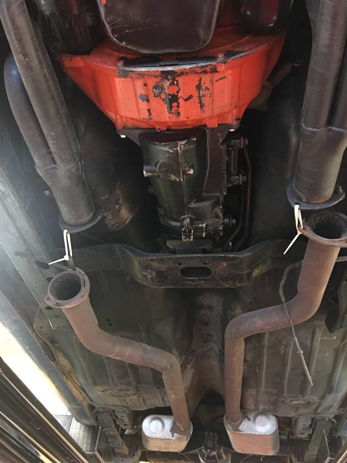

Too bad he doesn't show a pic of the glove box tire sticker...and,
- Dual Exhaust Plate
- Single 3/8" Fuel Line
- Front Disc Brakes
-Rear Axle Stamping showing 3.73 or 4.10 ratio
- 15" rally wheels w/DF code
etc

Lower valance is not RS. Looks like it has a cowl induction hood. Transmission cross member is in backwards. Looks like 4 leaf springs?
