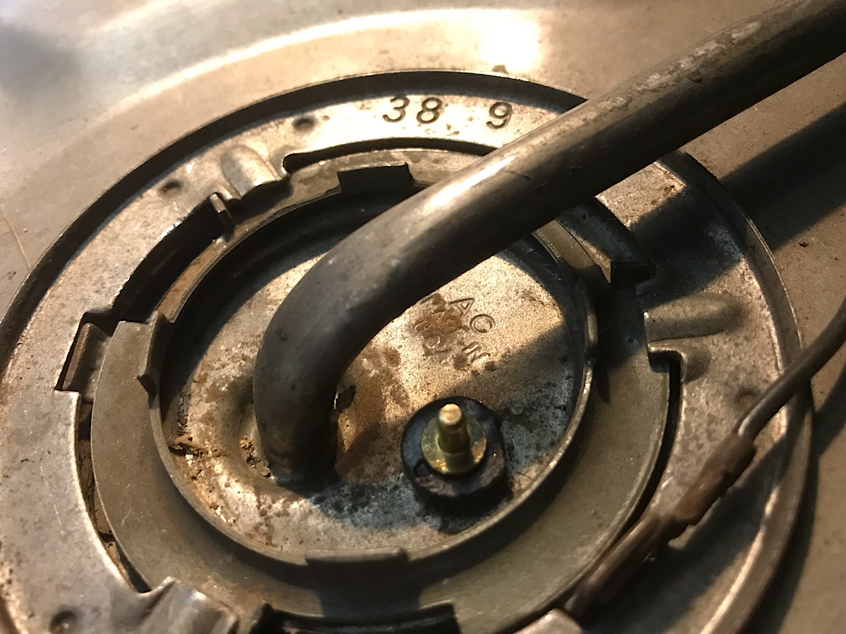

Thought I’d share some findings I discovered tonight. My fuel gauge has never worked as long as I have owned my Chevelle. My plan was to remove it and send it to a shop here in Ohio for a rebuild. I decided to check the resistance with my multimeter to see what was what.
1st up I noticed that I had an open circuit (1st photo) when I touched the multimeter positive probe to the sender post with the float at its empty-tank position. When I flexed the probe to one side or the other I was able to read a low resistance (.9 ohms) intermittently (2nd photo). Then with the probe flexed to the side i was able to get a reading of about 92 ohms with the float at the full-tank position (3rd photo)....

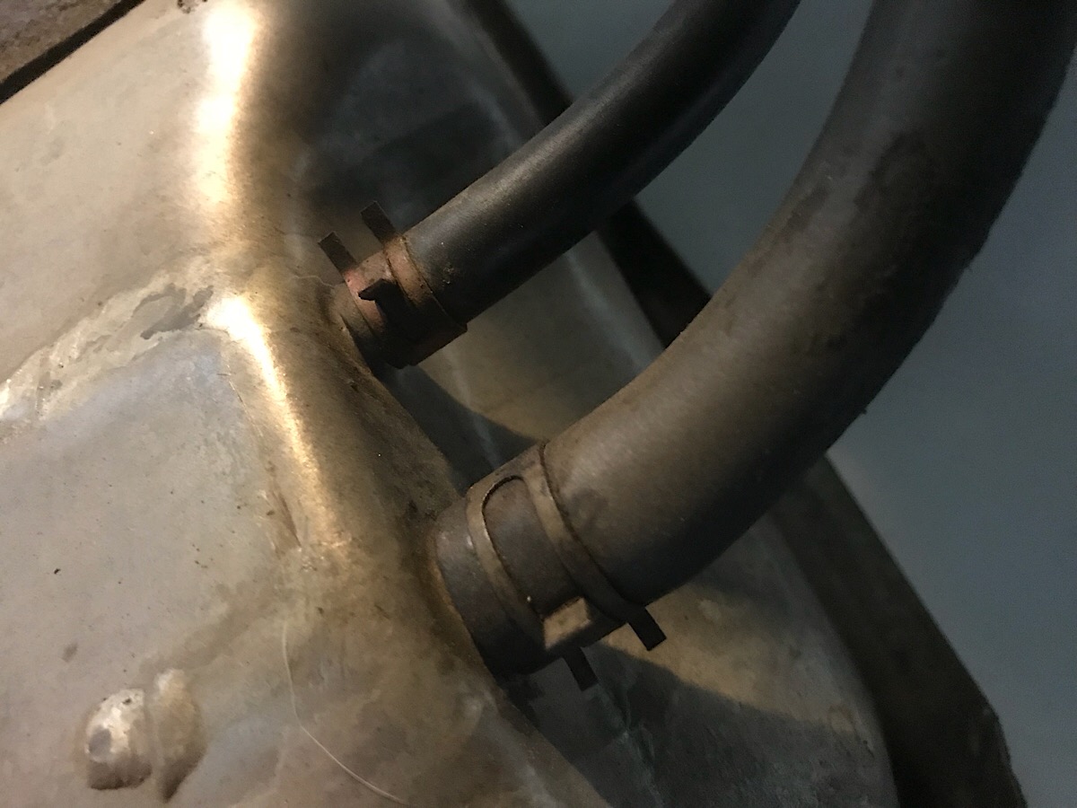

On the under side of the post I noticed the retaining nut was corroded. This nut (1st photo - green arrow) is responsible for making the connection between the post and the conduit (2nd photo - blue arrow) that connects to the float mechanism that measures resistance based on the float position. i disassembled it and found that there did not appear to be a good connection with the conduit that connects to the float mechanism. I cleaned up all metal contacts at this junction and made a new rubber gasket (2nd photo - green arrow) to electrically isolate the post from the sender frame. The old gasket was deformed and too thin (2nd photo - red arrow). Once this was done the connections worked just by touching the multimeter probes to the sender post and the ground wire. I am hoping this has fixed my problem. I’ll hook the sending unit up to the gauge lead tommorow before reassembley to ensure the sender is sending a good signal to the gauge.
