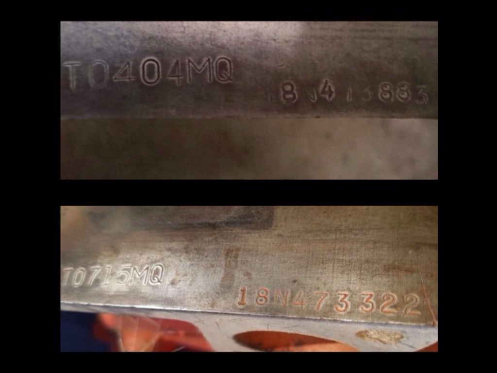

I need to do some house cleaning and don't want to sell anything fake. Do these stamps pass muster ?
VIN on the DZ is at the oil filter and is 19N5692 ( 3 or 5 ) 4.
Thanks,
Dave

Here's a couple MQ block stamping examples from past threads here, see links for more pics/details.
Both Norwood cars but Tonawanda stamps should jive also looks like dates before and after yours?
~ Pete
https://www.yenko.net/forum/showthrea...=131143&page=4
https://www.yenko.net/forum/showthread.php?t=142850

The Dec 18 DZ stamping matches up with others in the same time frame.

Let me compare what I have on file for the 68 L78 LOS cars I do have and see..

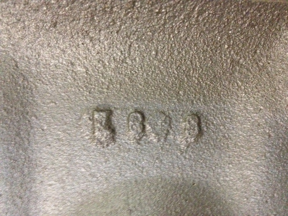

on the L78 pad.
Could I by chance get the casting date?

Casting Date - E 6 8. Thank You !
