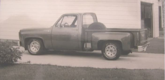

My '80 Chevy (which I ordered and followed down the line as it was built) was built in Flint and the front end never did match the rest of the truck.
