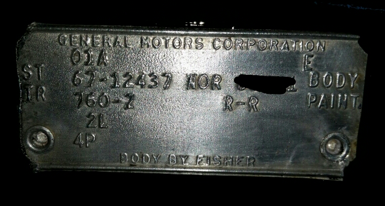

... Did any of the early 1967 Z28 Camaros have a cowl tag with
... NO 4P , 4L, or 4K code on the trim tags?

4P

No, the first 16 have 4P and then they went to the 4L code. There was a gap of no Z-28 production for about two weeks between the code change.

Default Z tag
Here's a cowl tag pic of #6 car
