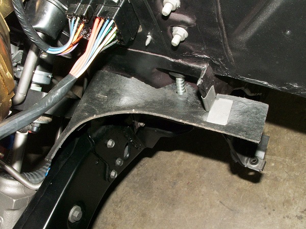

Here is one on a 69 Nova, Camaro is the same.

Are you interested in selling this seal? My car is a 69 similar to the photo provided by M22Mike. I need that seal if you're interested in selling it. Thanks
