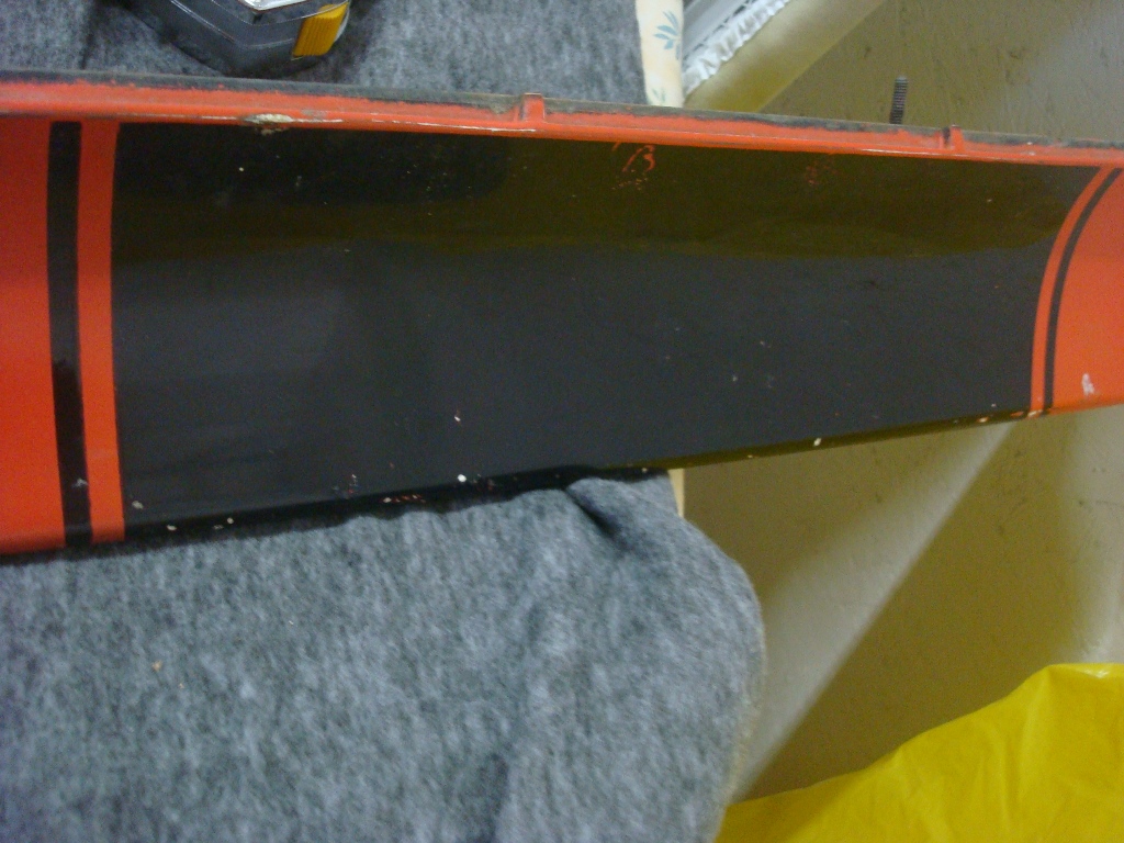

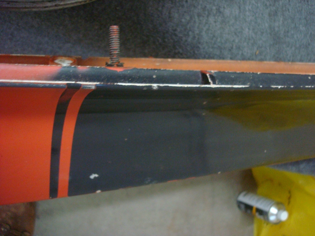

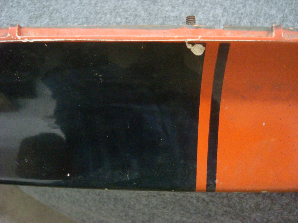

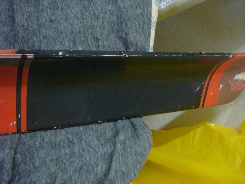

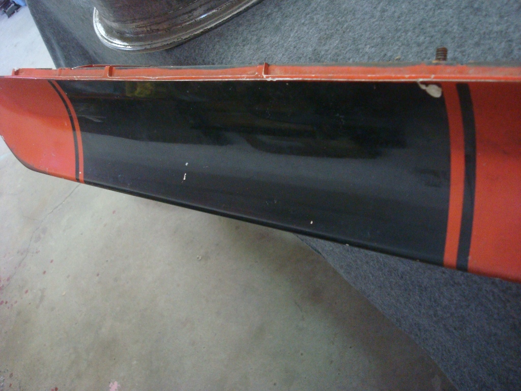

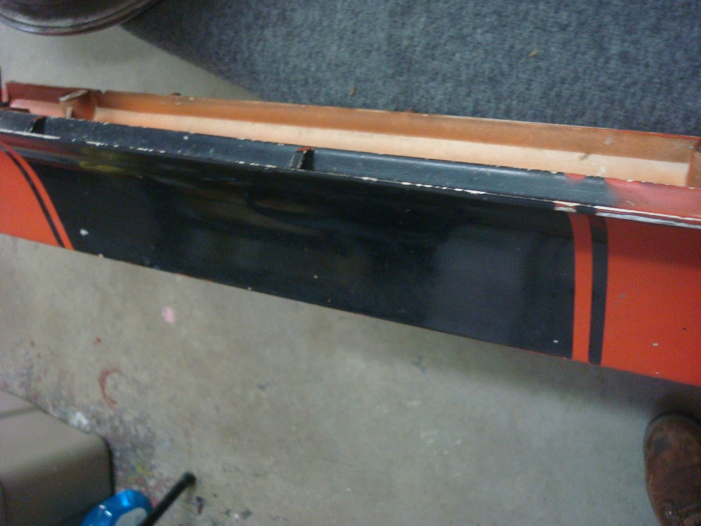

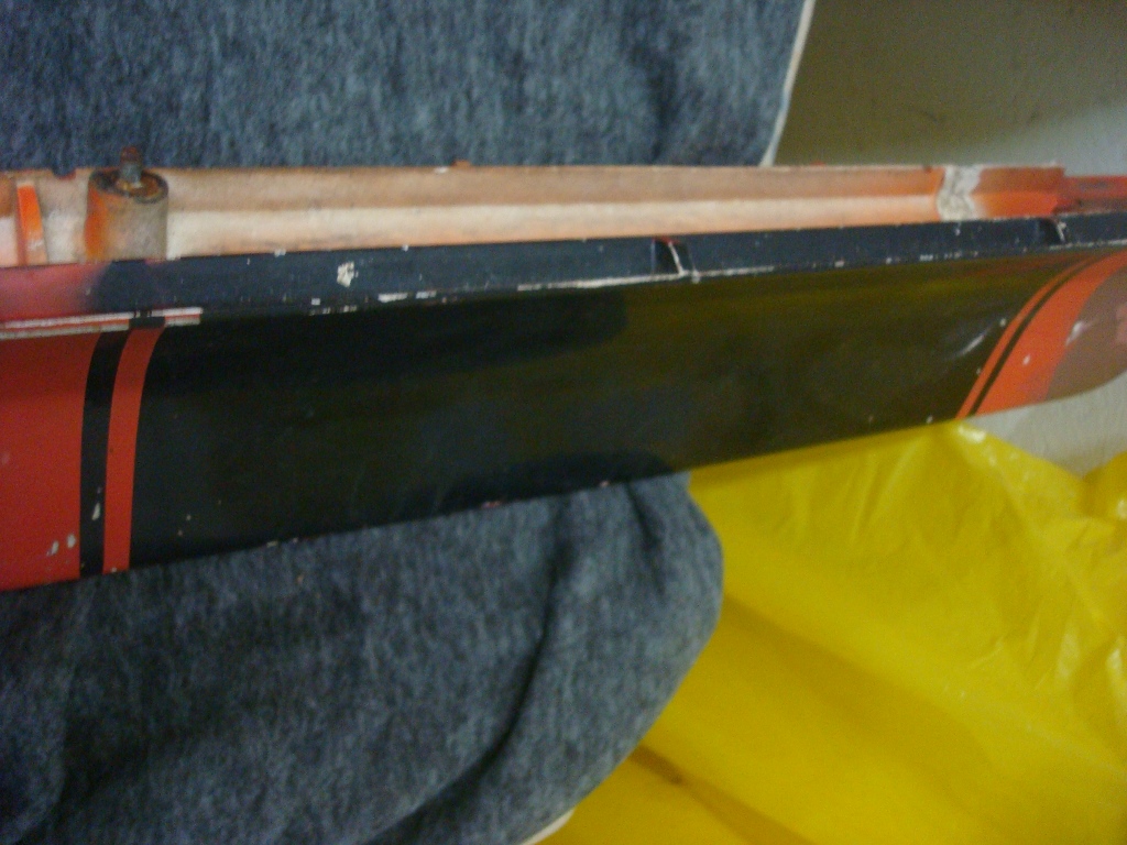

Here are pics of my original paint 07A Z/28 spoiler. I can take pics of my original paint cowl panel tomorrow if needed.
Hope this helps. My car is a Norwood Z.

Yes, that shows clearly the crisp rear horizontal tape line of the stripe on the rear of spoiler.
The front spoiler edge shows the overspray from the lack of tape covering that area, just like the original paint cars I have.
