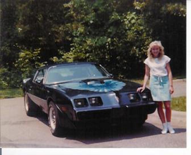

Default 1979 TA hi performance motor
looking to put a high performance motor in a 1979 TA 400 455 or whatever else...aluminum heads ok or not ...only requirements are that the original "shaker" setup be retained which probably means keeping the original carb . . Also not looking to cut up or modify the car/etc
No Fisher priced toys here

Both of these units were mine in 1985.
Thats not me in the picture, my hair was never that long.
These 4.4.4. TA's would actually wake up quite a bit with some normal cheap easy upgrades. #1 was disabling all emission devices and cutting the scoop open, then true duals and recurving distributor. Mine was fairly swift and i really enjoyed that car.
