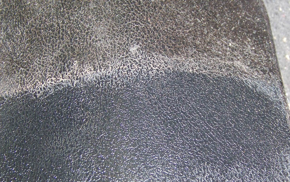

I second the rubbing or denatured alcohol -
here is a 69 dash pad which was incredibly sticky... used the same procedure on 70-up GM 4 bar steering wheels.
